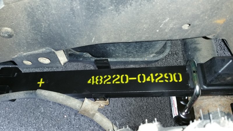

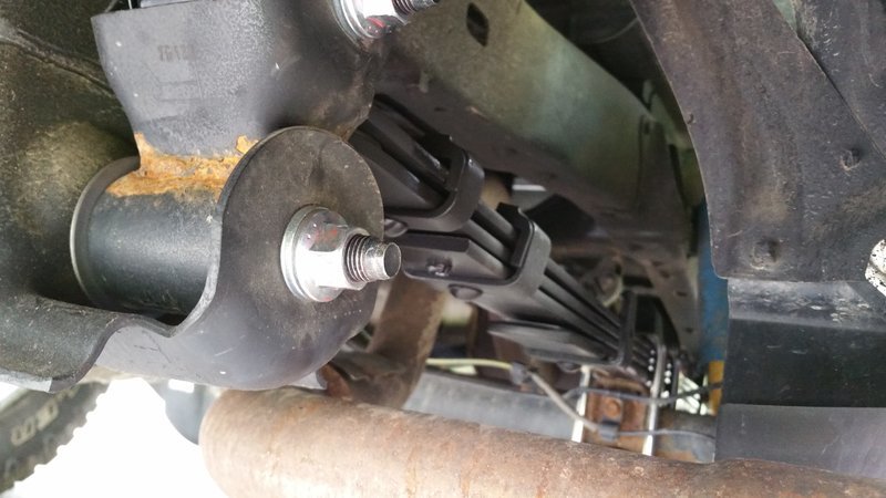

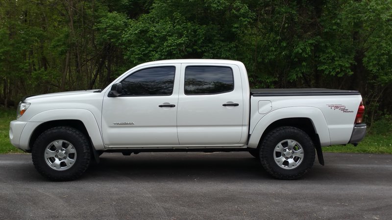

    I just got mine back today from having the recall performed. I'm not impressed and would agree with this statement. These replacement springs appear to have little to no arch, just like my sagging 4 leaf TSB springs from 2009. Here are pics.

  20. Apr 19, 2016 at 6:38 PM
    #20
    ImpulsedComa
    ImpulsedComa Well-Known Member
    Nov 23, 2014
    #142965
    494
    NJ
    05 Double Cab 4x4 SR5 V6
    Mine are exactly like yours. Brand new 4 leaf pack from my frame replacement and they are flat... useless
