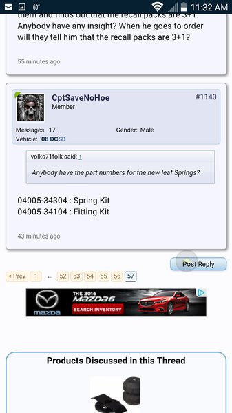

    Do you have a part number for he updated springs?

    #140351
    104
    Part numbers from another member here for the new springs.
