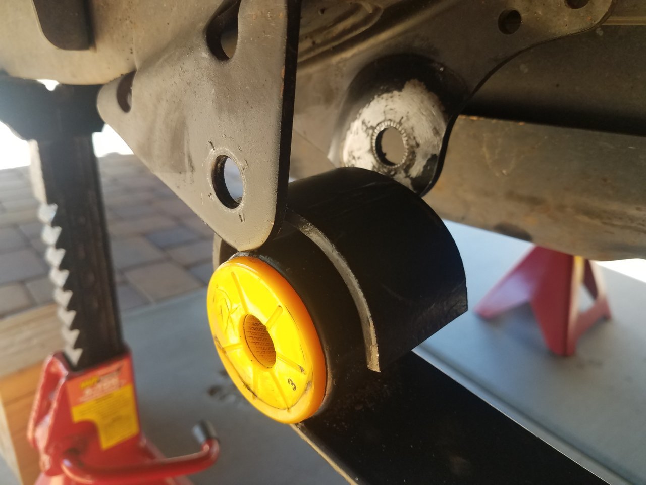

    Since we're sort of on the subject, where exactly would you put the SuperLube Grease for the Daystar/Trail Gear greaseable main eye bushings? I've got Dakar springs and the front bushing is worn out. Replacing with the Daystar poly bushings. I've read to put the lube all over the bushing, but also saw Timmy Toolman video that says only put the superlube grease on the inside of the bushing. I really want to avoid squeaking and creaking.

    Be generous. Anywhere the poly meets metal, lube it for the leaf spring bushings.
    Things like Whiteline LCA bushings are a tad different. They install into the eye of the lower control arms DRY, but once in, I lubed all surfaces where pivoting will take place.

    I'm glad to hear that. I just smeared it all over the poly and stuffed it in.
    When I installed my Whiteline LCA bushings, I lubed the crap out of the outer sleeve with antiseize. I really don't want to fight getting them out again.

    Ive been using the Wheelers poly bushings with stock shackles and OME Dakars for around 5 months, with around 5 off roading trips that were mainly mud, and no squeaks. Been pretty impressed so far because to be honest, I thought they would be squeaking by now especially after all the mudding. But like I said they are still going strong, and I figured if they started to squeak, I dont mind taking the time to take apart and regrease every thing, so no experience with the Daystar stuff or grease zerk. Keep in mind though it seems many people have different experiences with squeaking, some have it, some dont :notsure:
