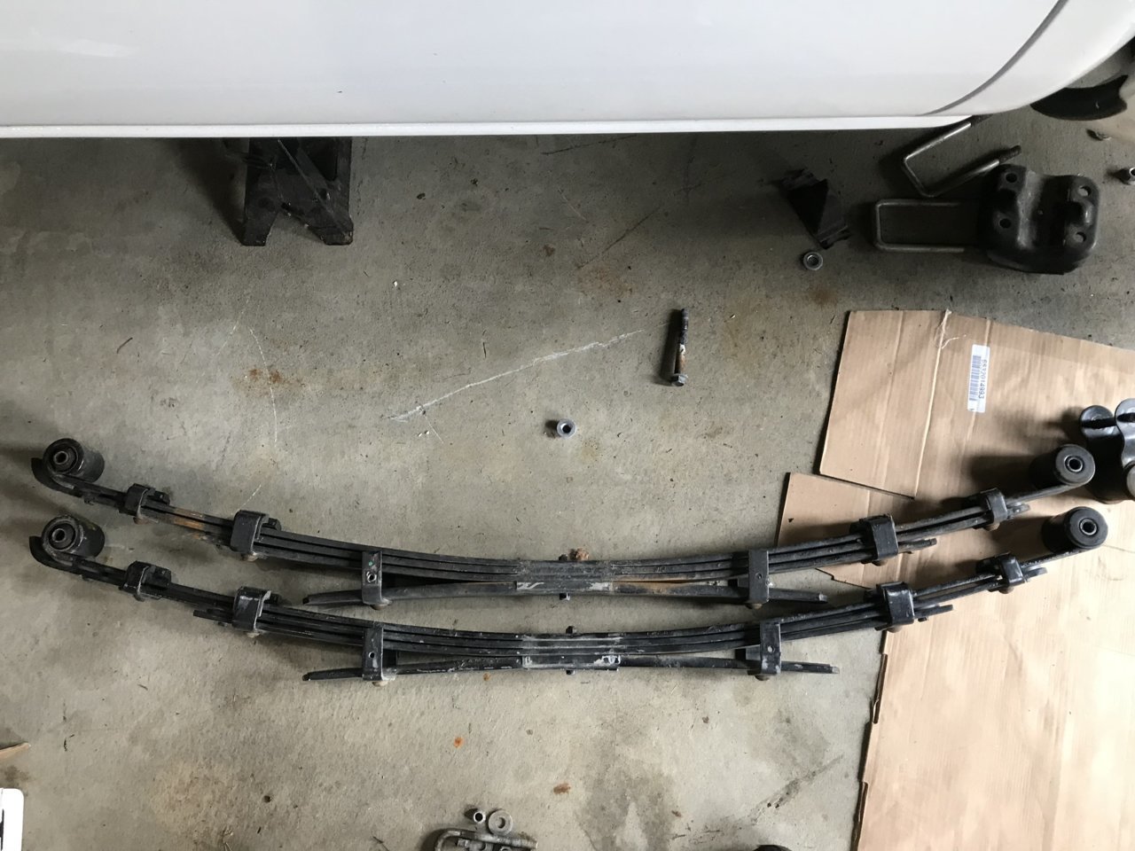

    4D8B31BA-67B4-485D-8971-7DF97561CF38.jpg Here is picture of springs off my limited(top) & springs off a TRD OR, though the part numbers say TRD PRO. I can’t say there is any difference minus the part numbers. Even though Toyota parts says there is normal and firm set up. I personally am taking out the overload and adding Icon aal with my TRD TX Baja Suspension Kit w/ Bilsteins (PTR13-35120). Getting details from Toyota is like finally reforming our government. Probably never gonna happen.
