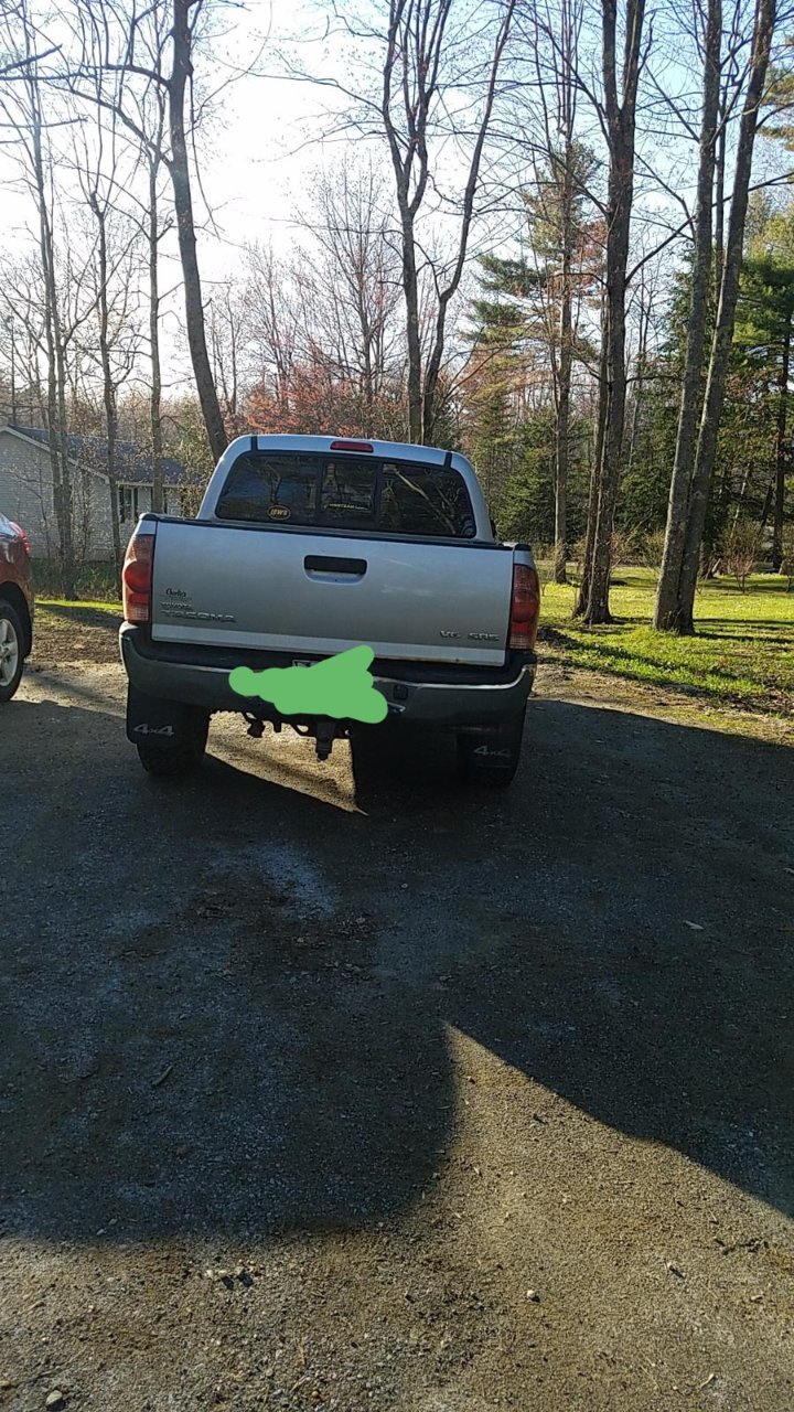

    Just wondering if it's a common issue with the rear leaf springs being bad after one year?
    I know that they said that they replace them when they did the frame last spring. The rear end on the passenger side is about 5in lower than the other side if I had to guess.
    Thanks in advance guys

    Pics and i would take it back to the dealer. If the truck is leaning that hard you have something major broken!

    That doesn't show much looks like you are parked on a sloped driveway. Need pics of the springs themselves. If one was truly 5" lower than the other then it would be resting on the bump stop which is only a few inches above a factory leaf.

    Put a level on your tailgate and show us a pic of the bubble

    Hard to tell in that picture

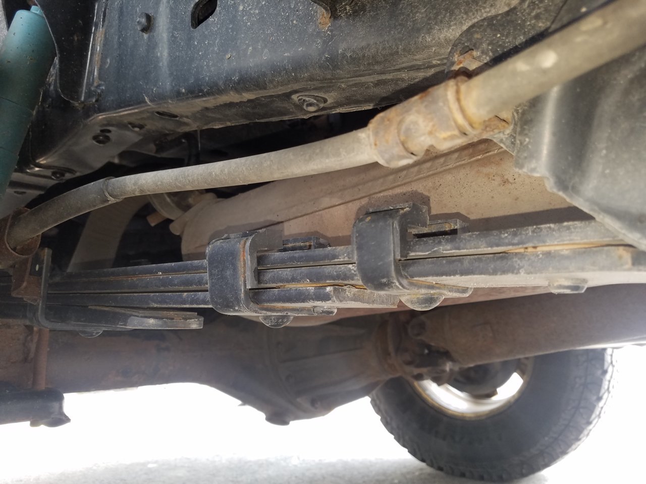

    This should be fairly obvious from under the truck...look at the driver side leaf...now look at the passenger side leaf. Do these two look the same?

    Passengers side

    Could it be a shackle and not the leaf springs?

    You need to take photos of both sides, front and back, and of the shackles.
    Measure the distance from the lip of the fender to the center of the wheel on both sides, too.
    The one you posted of the passenger looks fine to me. Looks like a normal amount of space between the leaf and the frame.

    Springs look fine, post front and rear hangars/shackle.
