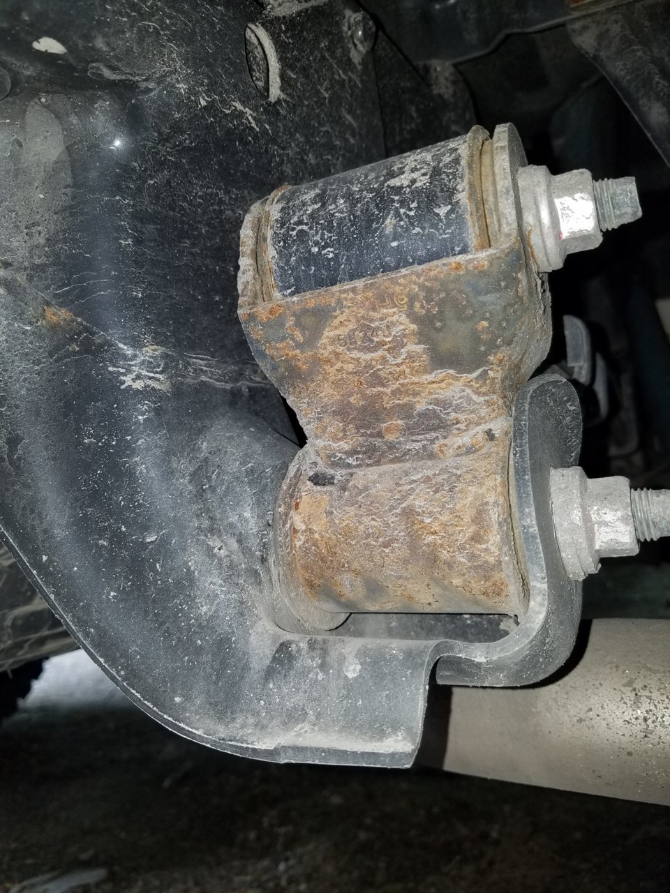

    Yeah, that ain't from springs, they'd just about have to be snapped in half to be that far off.
    That looks like the shackle either didn't get bolted properly & one of the bolts came out, or they re-used an extra-crispy Maine-winter-veteran shackle and it rusted in half.

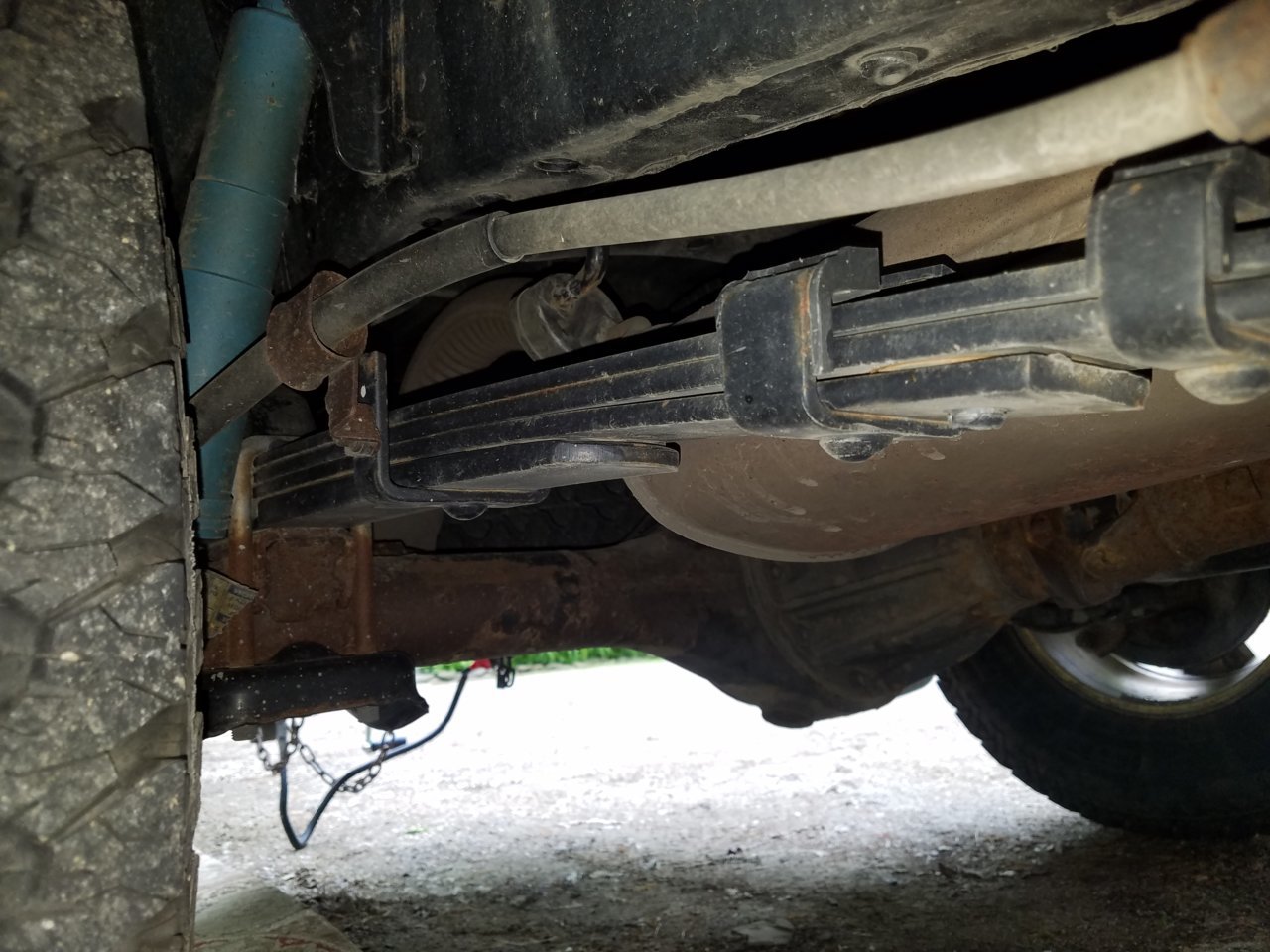

    A few more pics
  13. Jun 9, 2019 at 5:30 AM
    #33
    DJ Funktacular
    DJ Funktacular [OP] Well-Known Member
    Sep 3, 2009
    #22208
    98
    Maine
    '05 Toyota Tacoma TRD off road
  14. Jun 9, 2019 at 5:39 AM
    #34
    AKTacoParty
    AKTacoParty Well-Known Member
    Nov 22, 2012
    #91614
    444
    Jake
    Astoria, OR
    2013 DCLB
    885s, Dakars, Bilsteins, Allpro Sliders, Archive Garage Hammer Hangers, Wheelers Ubolt flip, super bumps, RCI front skid
    The leafs just look worn out. What do you tow? How much weight? The dealership may warranty that if it hasnt been to long.
