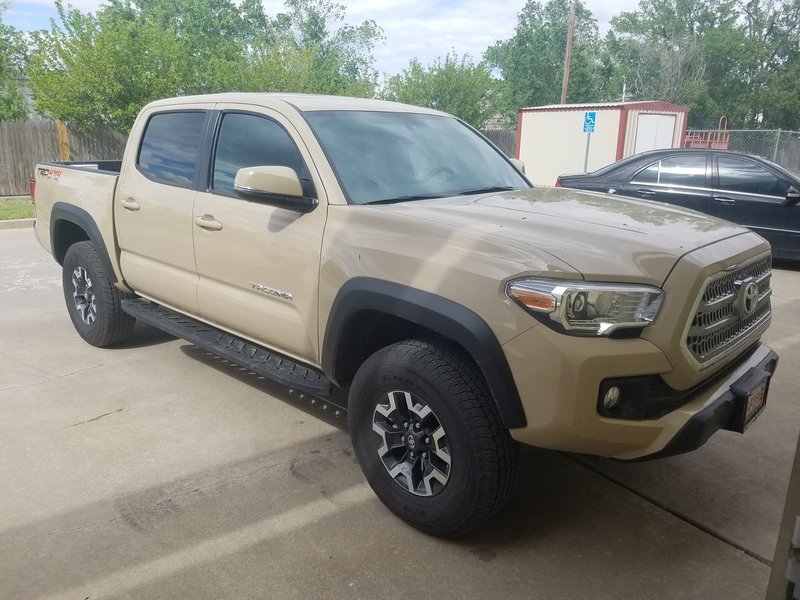

    So I'm having the same problem that everybody else is having, my rear leaf springs are creaking very bad, loud enough my neighbor could here it from his living room. It finally got bad enough that I took it to the dealership to see if they could fix it because everything that I've done hasn't worked.
    The things that I have tried are jacking up the rear end of the truck to relieve all the pressure off the leaf springs, pressure washing the leaf springs each individually, and then running a rag in between each leaf spring to make sure I get every particle of dirt out. After I did all of this I lower the truck down drove around for about 10 minutes and the creak immediately came back. I then rejacked up the truck, and recleaned all the noise reduction pads that I can get access to on the leaf springs. Again the creak came back.
    Took it to my local dealership to have it inspected to see if they could do anything they kept it for 6 hours, whenever I finally called back they told me the common "Tech tip" which is exactly what I did. The guy I spoke to told me that there was nothing else that they could do other than exactly what I did so I'm just going to have to deal with it until they come up with another idea. My truck only has 4500 miles on it and is still under warranty.
    I have read the other threads and all of them are saying to put a wet Lube on the leaf springs, but I don't want to do that because it'll just attract more dirt. So the other option would be to use a dry lubricant such as a silicone or graphite, but I shouldn't have to lubricate the leaf springs considering they don't come from the factory lubricated.
    What should I do? Because this doesn't feel right that they're telling me I should "just deal with the creaking untill they come up with another idea", considering it's a brand-new pickup
