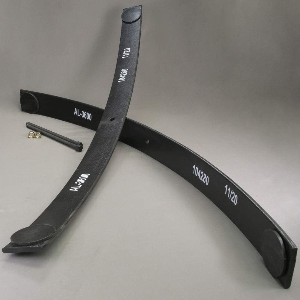

    I have a 2011 TRD sport access cab with 160k miles I just had shipped up to me in Wisconsin from Phoenix. I am getting a cap and didn't want there to be any possible sag so I thought I would try some AAL's. My truck only has two leaves plus the overload so I got some 36" long AAL's. I got these National Drivetrain 36" AAL's and I just finished installing them tonight. I got 3" of lift out of them, more than I wanted but they say they should settle a bit with driving. For $69 shipped from Amazon I thought I would try this before dishing out $500-$700 for a set of springs. Glad I did...might be an option for you.The truck I got from AZ is in such perfect shape. If your frame and suspension are in typical AZ condition I would not feel the need to replace anything. You guys don't know how good you have it out there! :)
    Everything on the under carriage is like new. Bushings, fasteners, basically everything is perfect. I did have a slight tear in the inner drivers side boot I felt the need to replace before winter sets in. Sorry I forgot ...you guys probably don't know what winter is!
