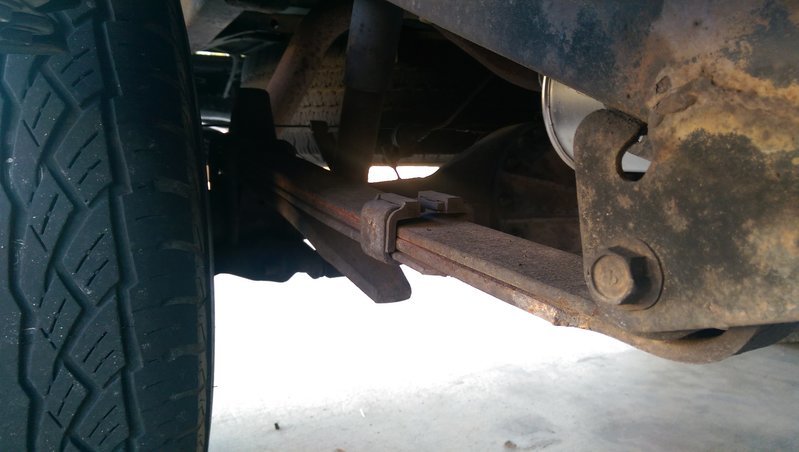

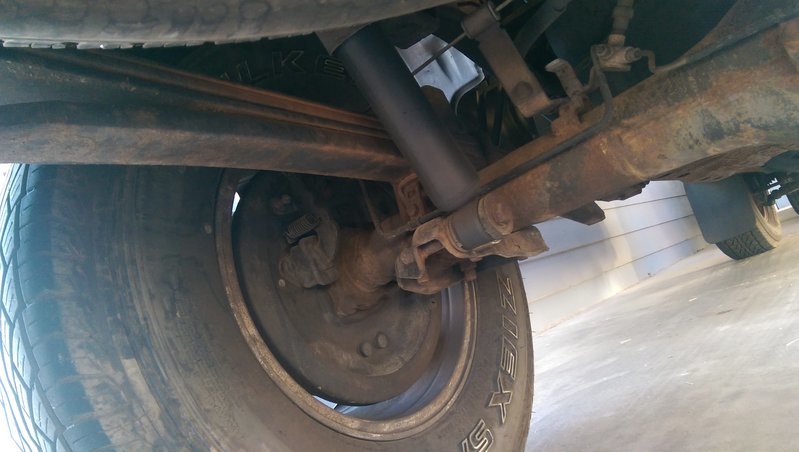

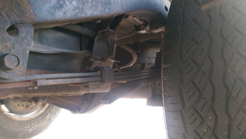

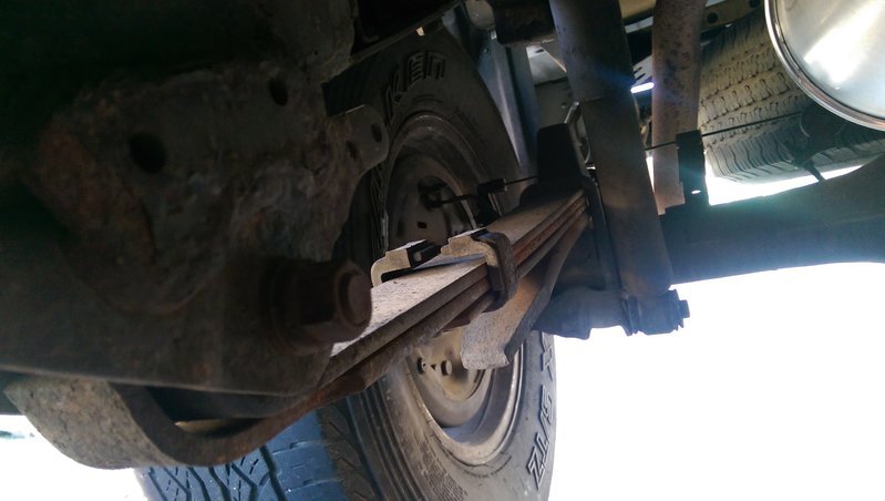

    So I was looking at my rear leafs and noticed they have a real negative arch to them. Truck sits about level or just slightly sagging in rear. I'm sure that they are original (246,000 on the clock), the PO didn't do much to her other than oil changes. Shocks are original as well. Question is.. is there any kind of fix to bring them back to positive arch for the time being until I make a decision on what kind of lift to install? It will probably be next summer before I'm able to lift it.
    Any thoughts, opinions, or suggestions are appreciated.
    Thanks guys.

    Add A Leaf (AAL) kit would hold you over until you make a decision.

    Looking at the pics again, they don't seem that bad. There are pics posted here showing much worse. I've learned here that these leaf springs (stock) sit almost flat when new, making for a softer, more car like ride. We can thank Toyota focus groups for that.
    I had a set of aftermarket stock lift springs put on back in August, the difference is night and day, with at least 1+ inches of lift back there. I have 5100's all the way around, with the fronts set in the middle to level the truck. Before the new leafs the truck was level, after new leafs the truck has a bit of a rake to it, but I have front coils with 128K miles on them, so that may contribute to rake. Oh, and the new leafs sit almost flat, with a little "smile" at each end of the springs.

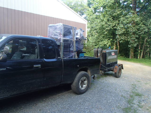

    Super Springs
    I bought the Heavy Duty ones from General Spring then added Super Springs
    Fpr me it works because it is used as a Truck most days it has 1000 pounds in the bed and often as not Towing a Diesel welder as well001.jpg
