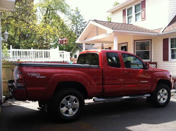

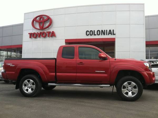

    I had TSB done on my 2010 and installed EIbachs, 5100's set at "0".
    Then added 265/70/17 Cooper S/T.
    First pic is after TSB/ Eibach
    Second is with Coopers installed.
    Little rake, but that's what i prefer unloaded.
    Sits higher, but not too high. Rides much firmer.
    Sry, I see you have a DC.
