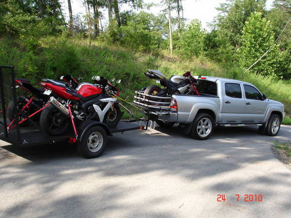

    So how do you get the bike in the bed? Is the tailgate strong enough to ride it up a ramp or do you ride it on from an elevated dock?

    My first tailgate bent from me standing onit (250ish lbs back then) while loading a walk behind lawn mower. Even the reinforced TSB tailgate I have feels flimsy. I'll be adding more support to it at one point.
    I doubt the stock tailgate can handle the weight of a bike+rider.

    I just had my springs replaced and the truck behaves like it should have all along. I'm heavily involved in motorcycles and even after my first drive in the truck (before I knew about the spring TSB) I felt like the rear suspension was too soft - and that's with the truck unloaded.
    With the new springs, it really feels like the front and rear suspension are actually working together. I just really hope they don't "relax" too much. I really like how the truck rides now.
    I also just did this to my tailgate to solve the motorcycle-on-the-gate bending problems.

    After looking at your pic , the answer is definitely a yes

    I just use a ramp and push it on. I haven't had any problems with the tailgate.
