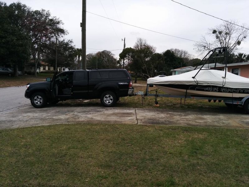

  20. Feb 8, 2014 at 12:58 PM
    #20
    Jaxkiter
    Jaxkiter [OP] Member
    Jan 20, 2014
    #121098
    15
    Alright, finally installed the rear leafs and 5100's this afternoon. Piece of cake. Still haven't gotten around to installing the new shocks up front. Planning on maybe .85 to take out a little of the rake, but not much. I like having the rear up higher. Also took a second to hook the boat up just for kicks to see how it handled the tongue weight!
