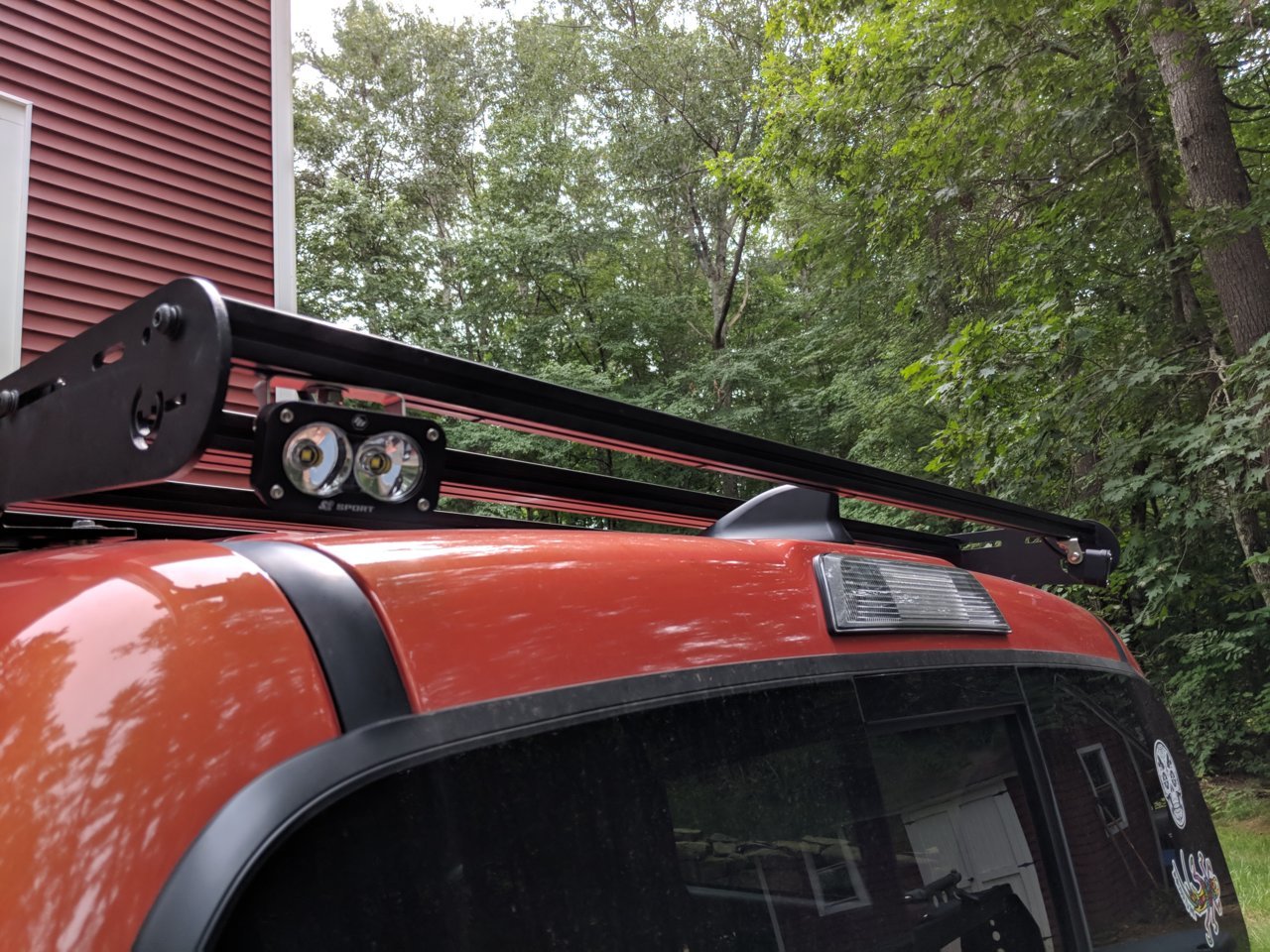

    I installed a couple of BD S2's under the last bar on my prinsu. Illuminates the area nicely. I ran the wiring in a channel facing forward after drilling for some small zip tiles to hold it in place. The mouting brackets for the lights are held in place with some carriage bolts.

    where did you run the wire to for power/switch?

    I ran the wires through a plastic wire loom alongside the windshield into the engine bay to a switch pro..
