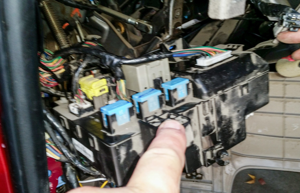

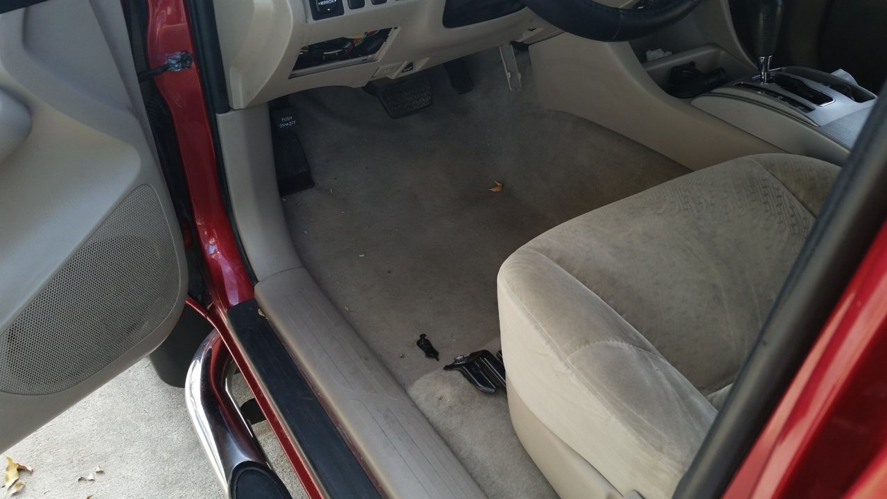

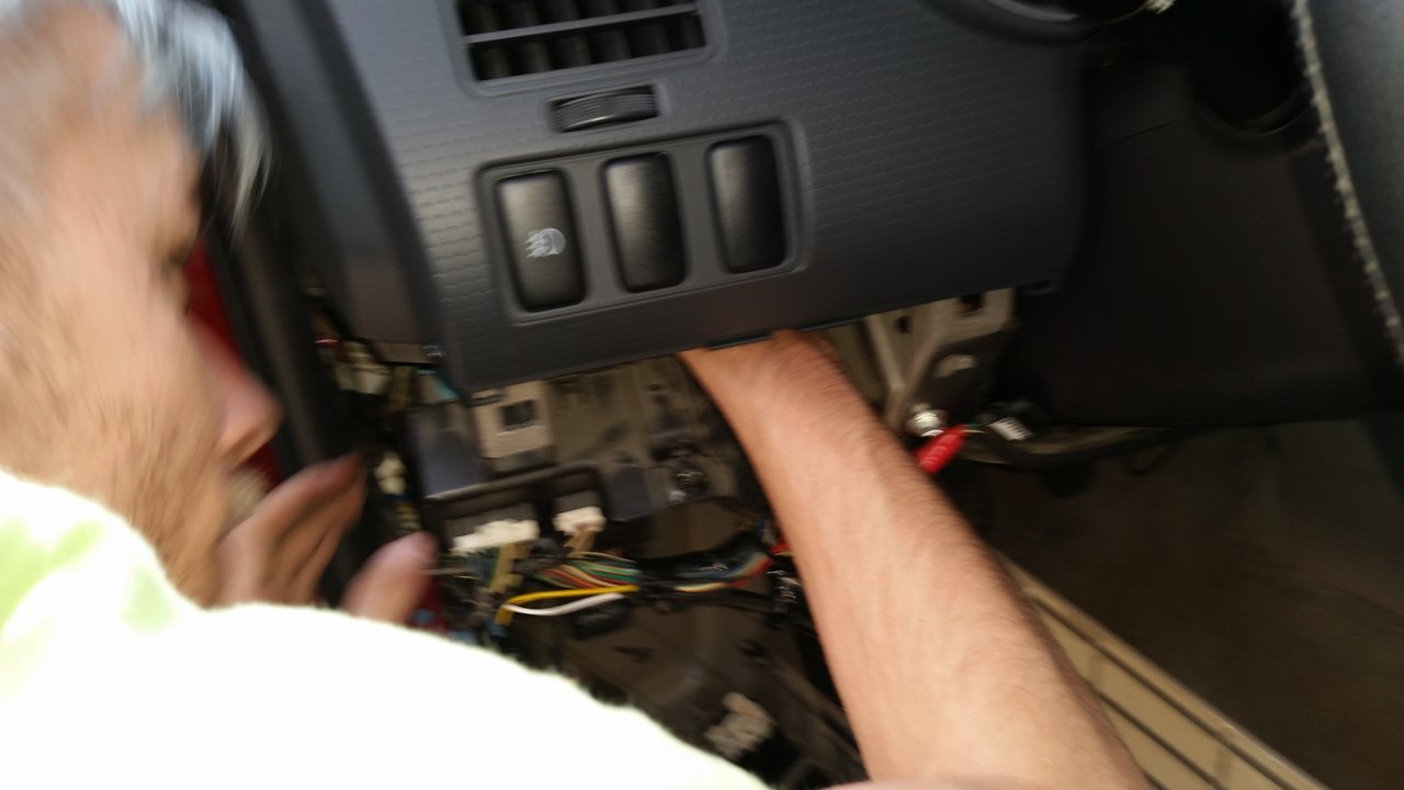

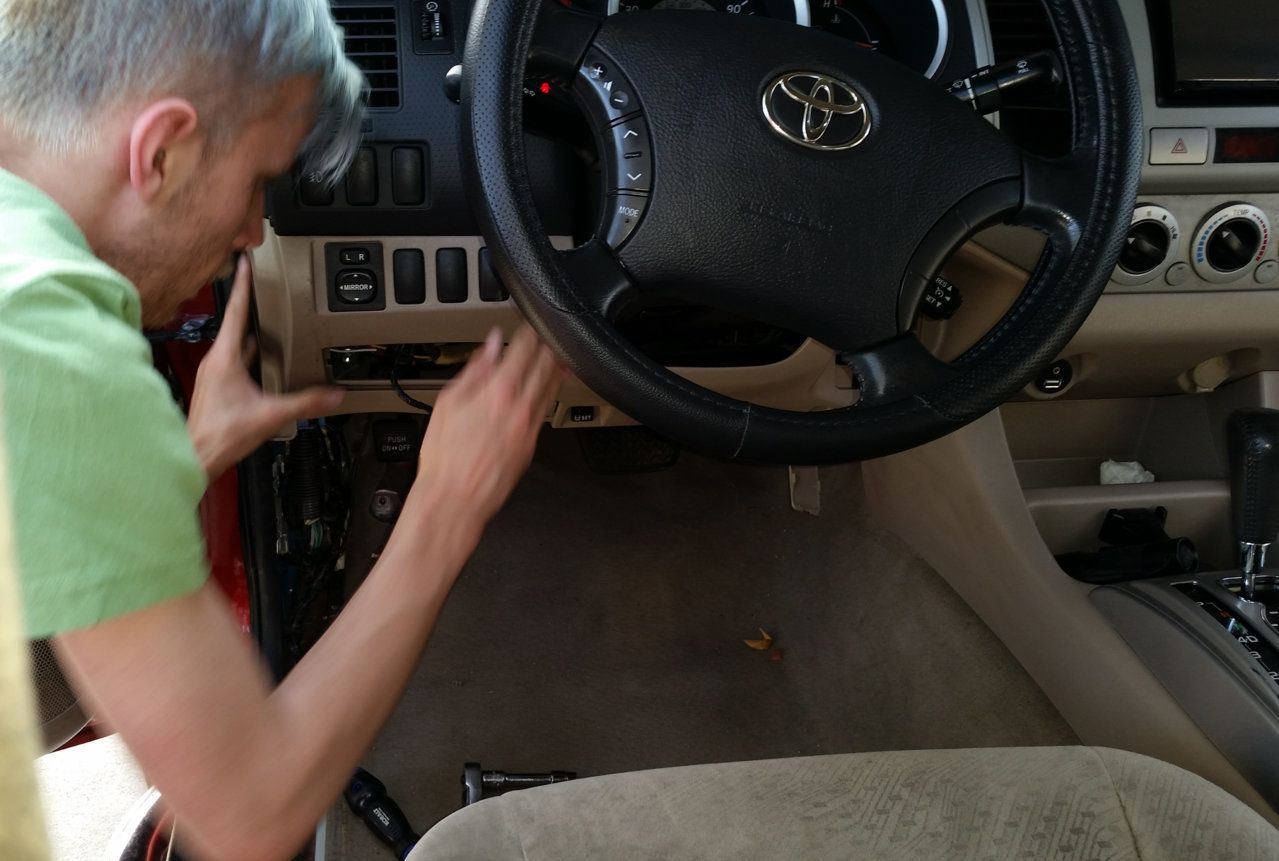

    It's a PITA. Have to remove the lower dash, foot rest, side panel, and door sill. Then, loosen the fuse/terminal box, and it's on the BACK.
    20171221_133800.jpg Lower dash has to come off
    20171221_134620.jpg And the door sill
    20171221_132620.jpg Son is smaller and more flexible
    20171221_133504.jpg It's the BROWN relay I'm sort of pointing at.
    I got my relay at Amazon, our small shops didn't carry them.
