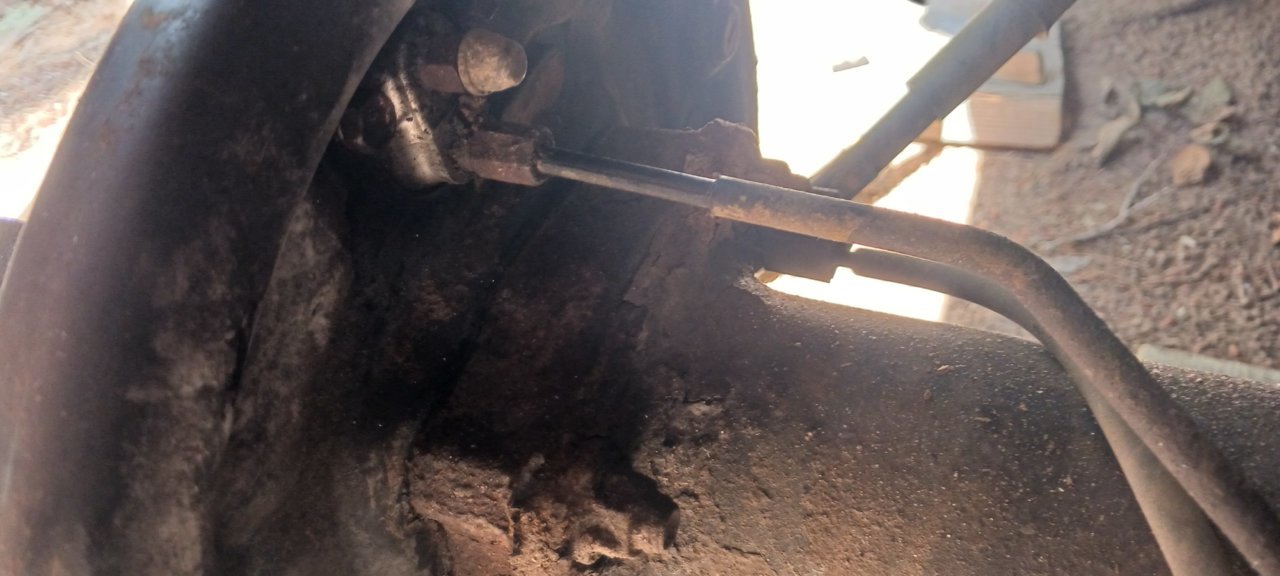

    Hey, I can't find anywhere that has that last section of brake tube that leads to the wheel cylinder. I had to cut mine off and plug it with a machine screw after a catastrophic cylinder leak offroading - now I have to replace it. Any ideas where I can order one from? It has all these bends in it, maybe I have to make my own? 20220717_115621.jpg

    If you can't order oem you might try Napa, but you might have to bend and flare your own hard line.
