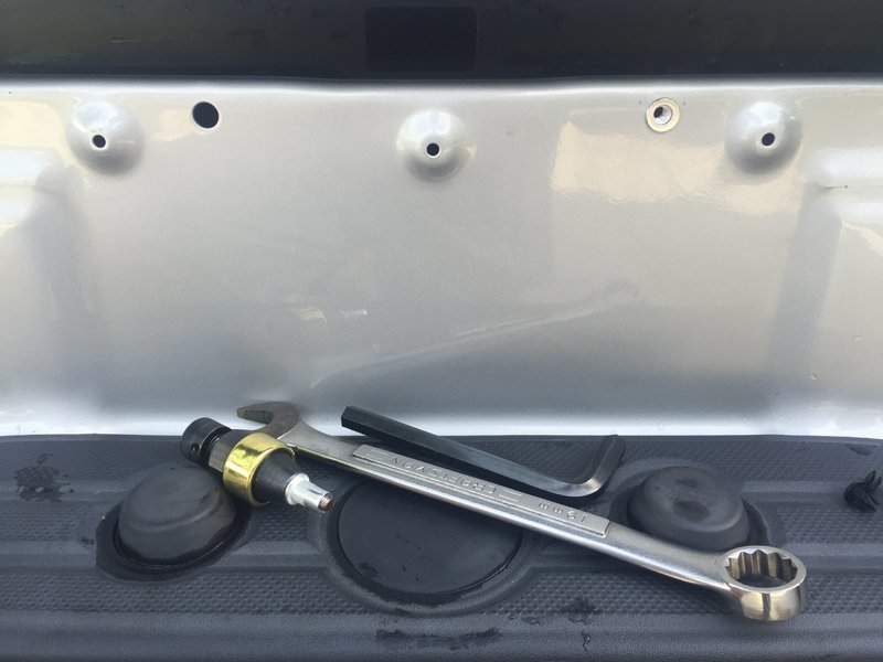

    Took a 10mm wrench on the backside of the plate accessed from under the truck and held the nut in place while using my otherhand to tighten with the supplied allen. Took 2-3 minutes tops, my tow reciever didn't really get in the way.

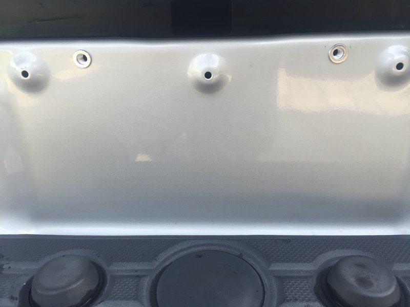

    I pulled the plastic off the bumper and found holes already there, so I installed so threaded nut serts and real threaded bolts.

    Nutserts would have been my preferred method to fix too.

    just curious... where did you get the inserts and what sizes did you get? I would like to do this because it seems to be the best, most permanent way, to fix this issue
