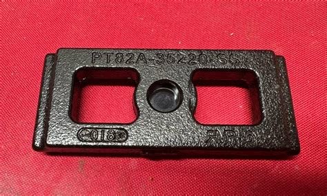

    I may be hazy memory, but I just bought a Toyota OEM 1/2" rear block to correct my drivers side taco lean (as opposed to a 1/2" block that goes into the leaf pack, e.g. toytec).
    I thought it came on one of the models on newer Tacomas, which is why it was OEM.
