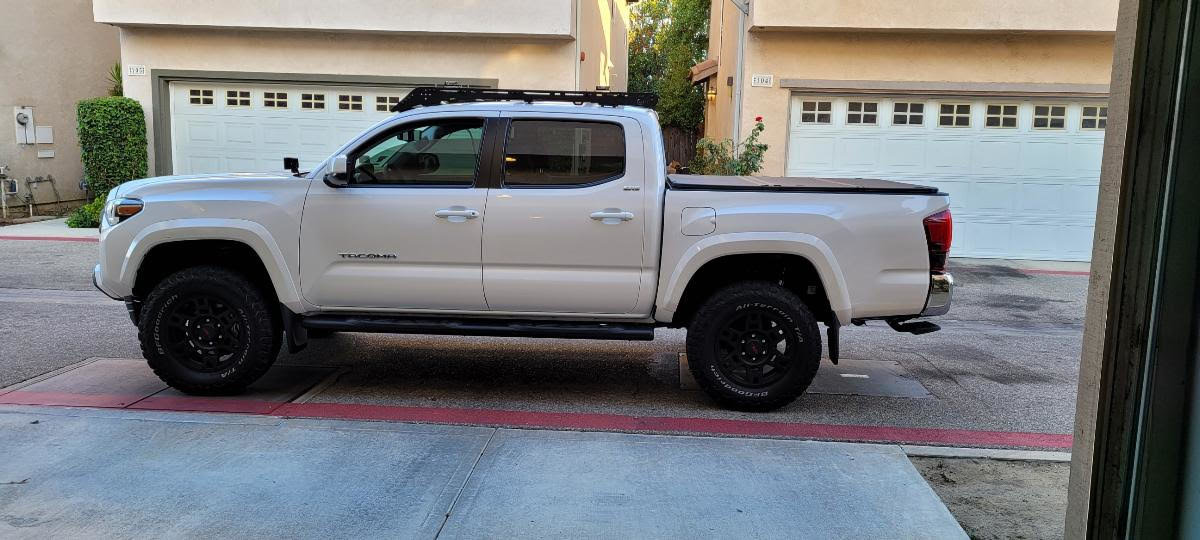

    Hi Everyone-->> need some advise I just got my Eibach Pro kit (set on the lowest ring) on my 2019 Taco 2" front and 1"block rear. I'm not quite happy with my stance (Please see Image). I thought the rear would give me a 1" lift from the factory but it look like it only gave me a 0.50 inch So anyway I want to lift my rear a lil bit should I get a 1.5" or 2"block or should do ALL 1.5" or 2" and of course I want to keep my ride quality.FYI I will be loading my bed with 120lbs RTT when I go camping and 180lbs. dirt bike when I go riding. Please advise Thanks in advance. my tires are 265/70/17. Thanks y'all

    Do you want it to work well or just look like it does?

    AAL x10 million... Blocks rust/crack and will kill your leaf springs

    I did a toytec aal. Been great so far 2+ years. Also I have a leer shell too

    Add a leaf. You will be adding overall spring force, so it will prevent sagging when loaded. A block won't do that.

    I want to work right any recomendation for brand and height? Would my ride be better Vs. The block?

    Aal

    Pro comp sell aal or rough country I believe
