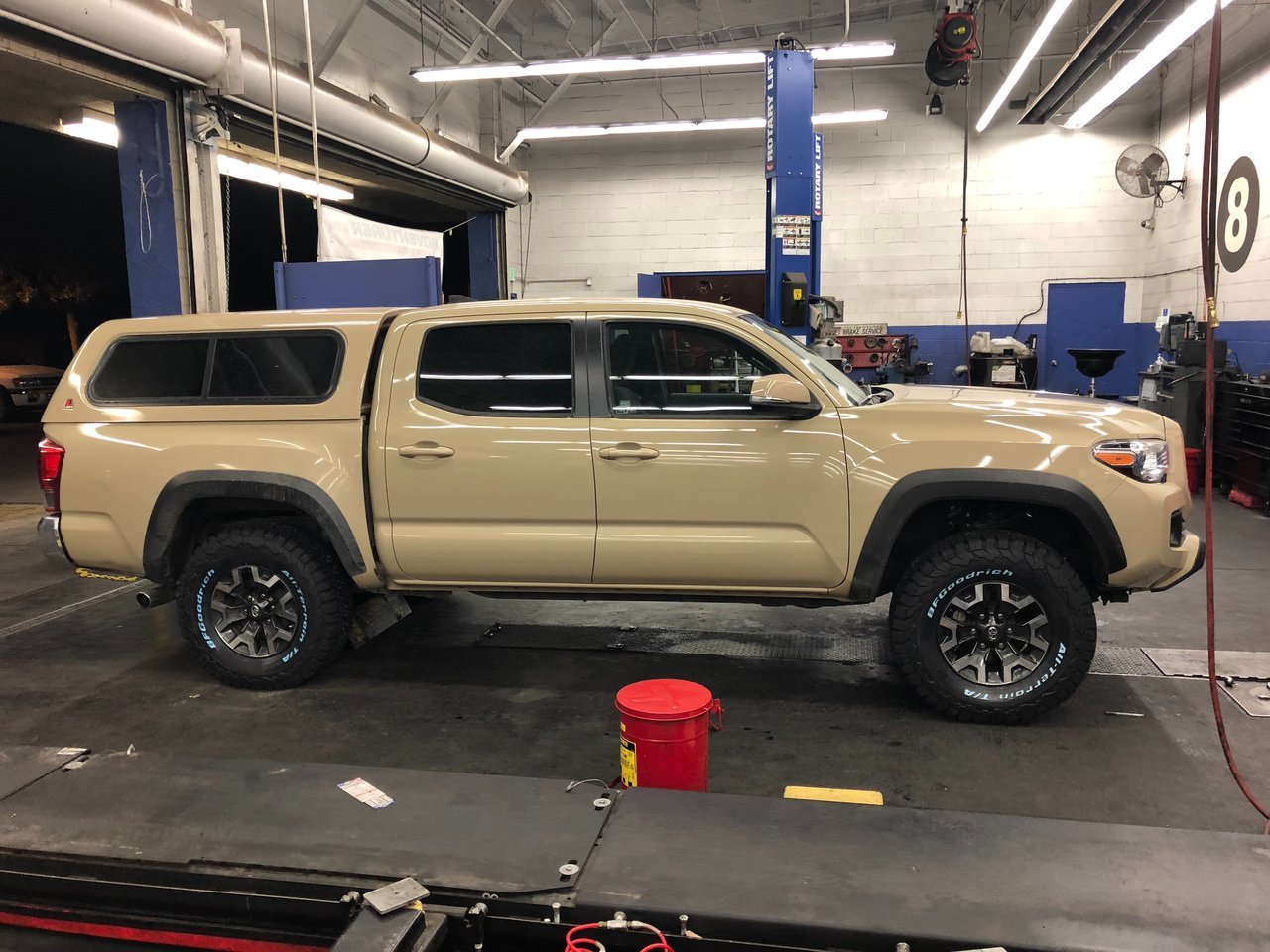

    I'll throw my 2 cents in as well for Marie @Headstrong. Great people and Marie is very knowledgeable. Just finished get my lift/suspension from them in yesterday.
    5100 all around, uca, aal and new coils.
    Significantly improved the ride and feel.
