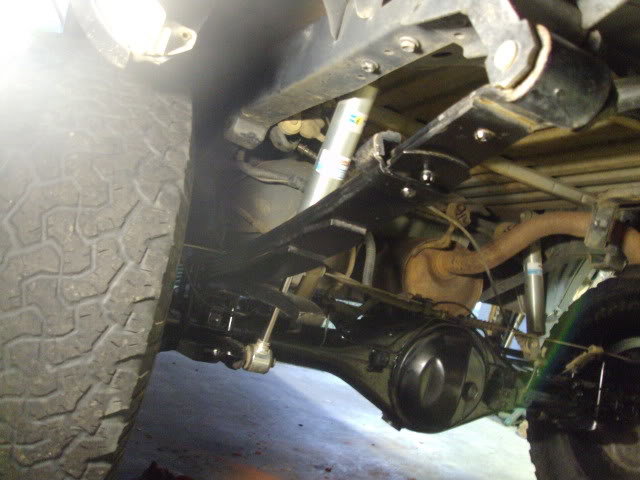

    Most people can fit up to a 265/75/16 at stock height. That's about a 31.6" tall tire so you should be fine with 31"s. A slight lift wouldnt be bad though, just 5100s set at 1.75" and a 1" shackle in your case. How does your leaf pack look?

    As it sits right now I would need the 1.75 just to level it out. My leaf pack looks a little sad. It doesnt have much arch to it. The truck has almost 150k on it and those are orgional leafs. It doesnt ride bad in the rear at all though. Ill see if I can post a Pic real quick.

    A couple pics of my truck as it sits right now and my leafs.

    You can run 32"'s w/stock susp. but if you go up any amount in rear you'll need shock upgrade.. mine with 3" lift & 5100 series (5125's)
