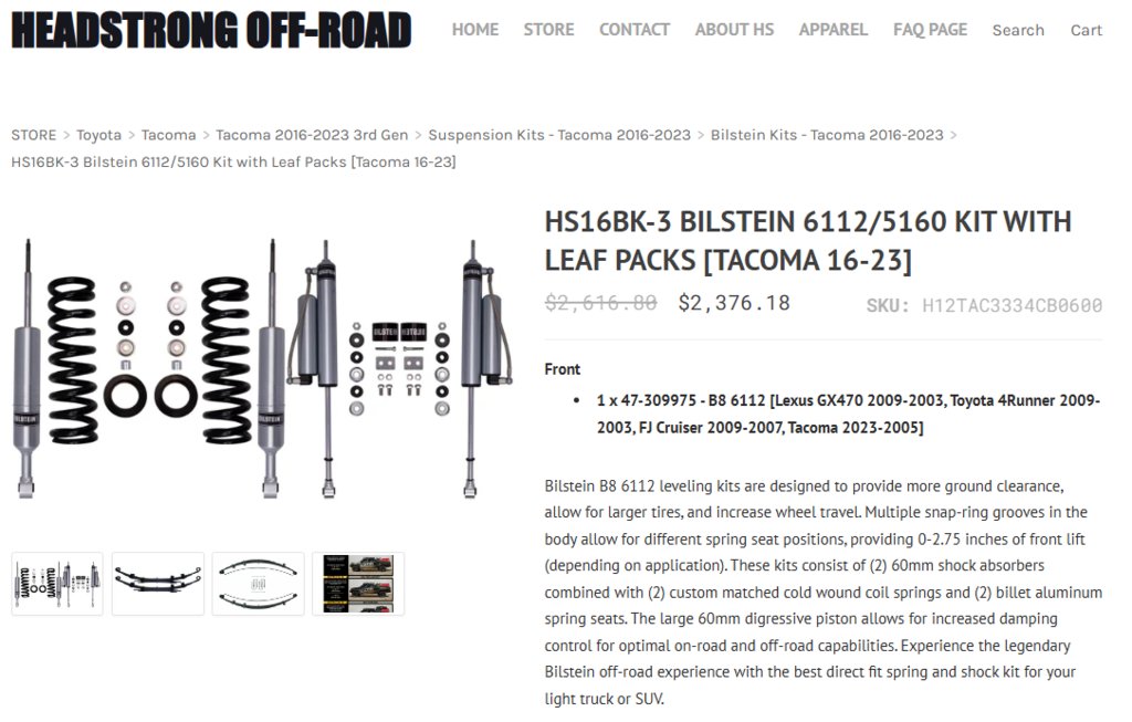

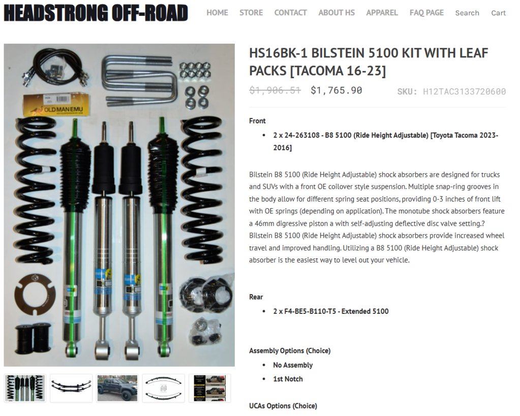

    I just tossed together a couple kits on Headstrong, and it's only about $600 more to go with 6112/5160s vs 5100s all around. Icon RXT pack included, along with assembled front coilovers. I chose the 2887 ARB coilover, but honestly I'm not sure which one you'd want (i'm not versed in ARB coil springs). You mentioned you'd like to go 6112 in the future, so I'd suggest the whole buy once cry once methodology.
    Tennessean[OP] likes this.
