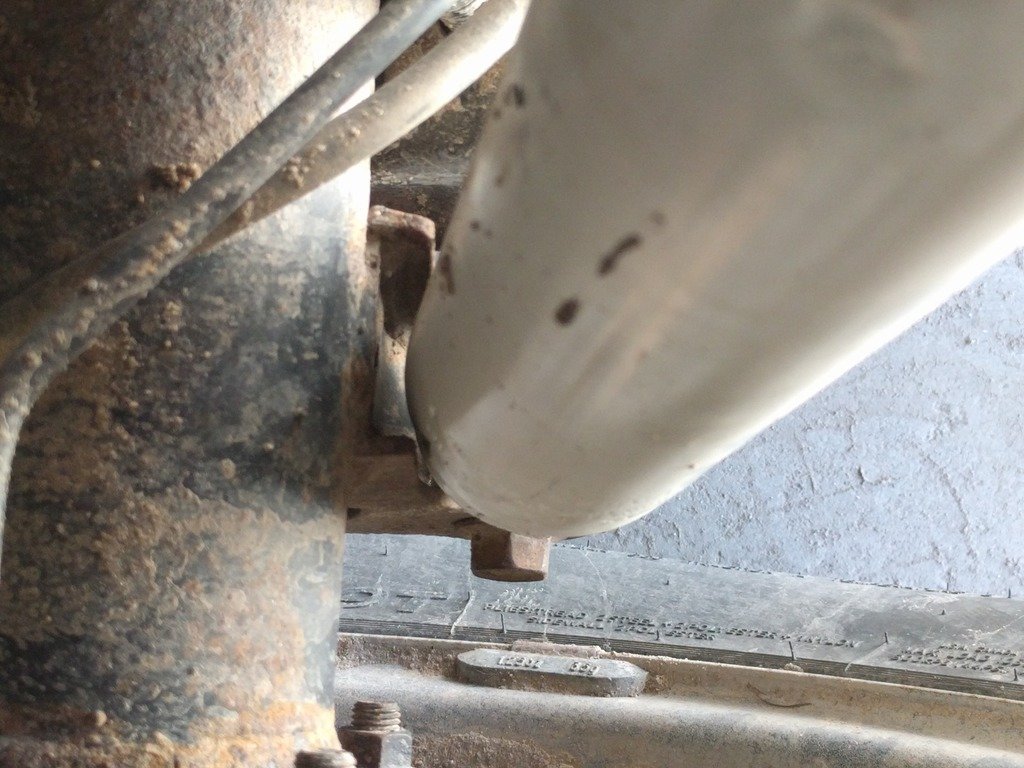

    Ok guys installed my shocks and it seems the drivers side is rubbing the sock body. What would be the best thing to do for the fix. The other side is 1/2" away this one is about 1/8" and rubs maybe on the down stroke? IDK I don't see anything bent.

    What brand is that? I installed 3/1 procomp lift on a tundra at work the other day and it's the worst lift I've see in my life. I'll take pics on Monday

    it's an ES9000 shock but I don't understand why it's that close while the other side is fine. Think I'll just grind that tab down

    Ya I know you need to grind that down for the ome's

    Ok so it's not just me lol. I know the pro comps ES9000's are cheap but they do ride 100% better than stock. Thanks
