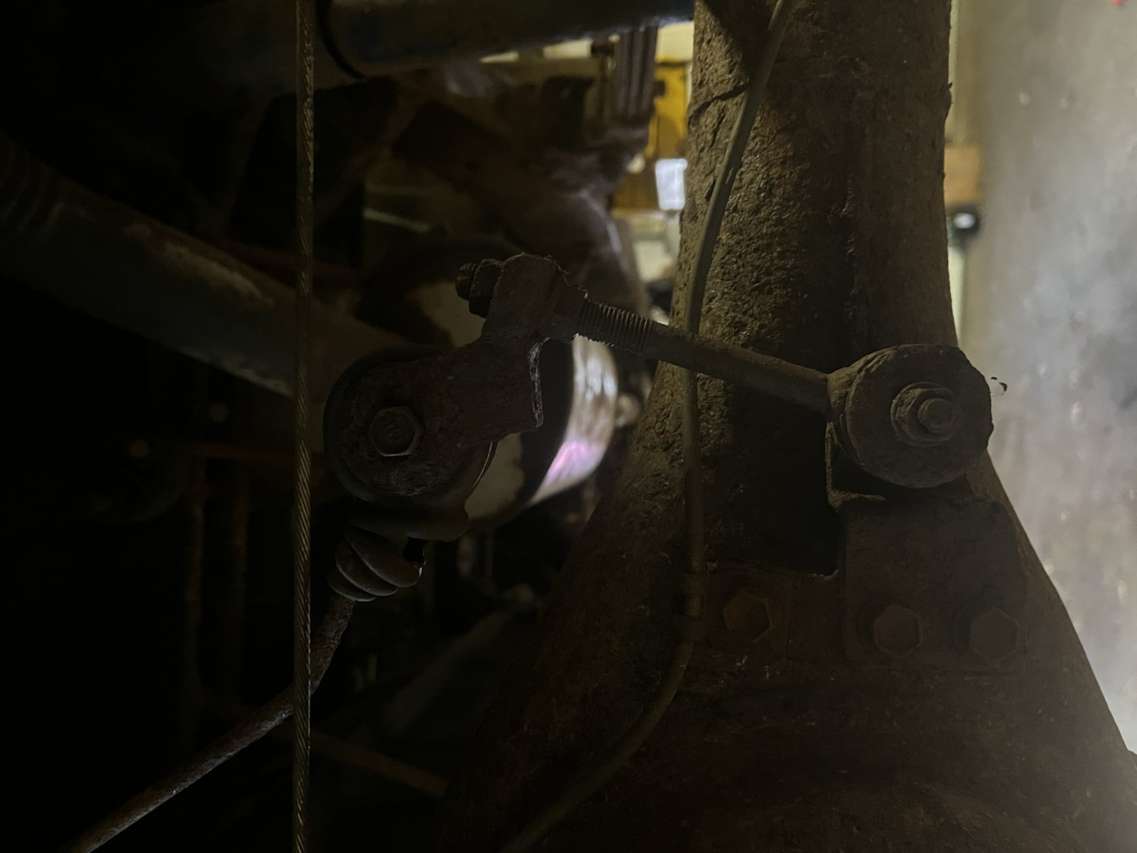

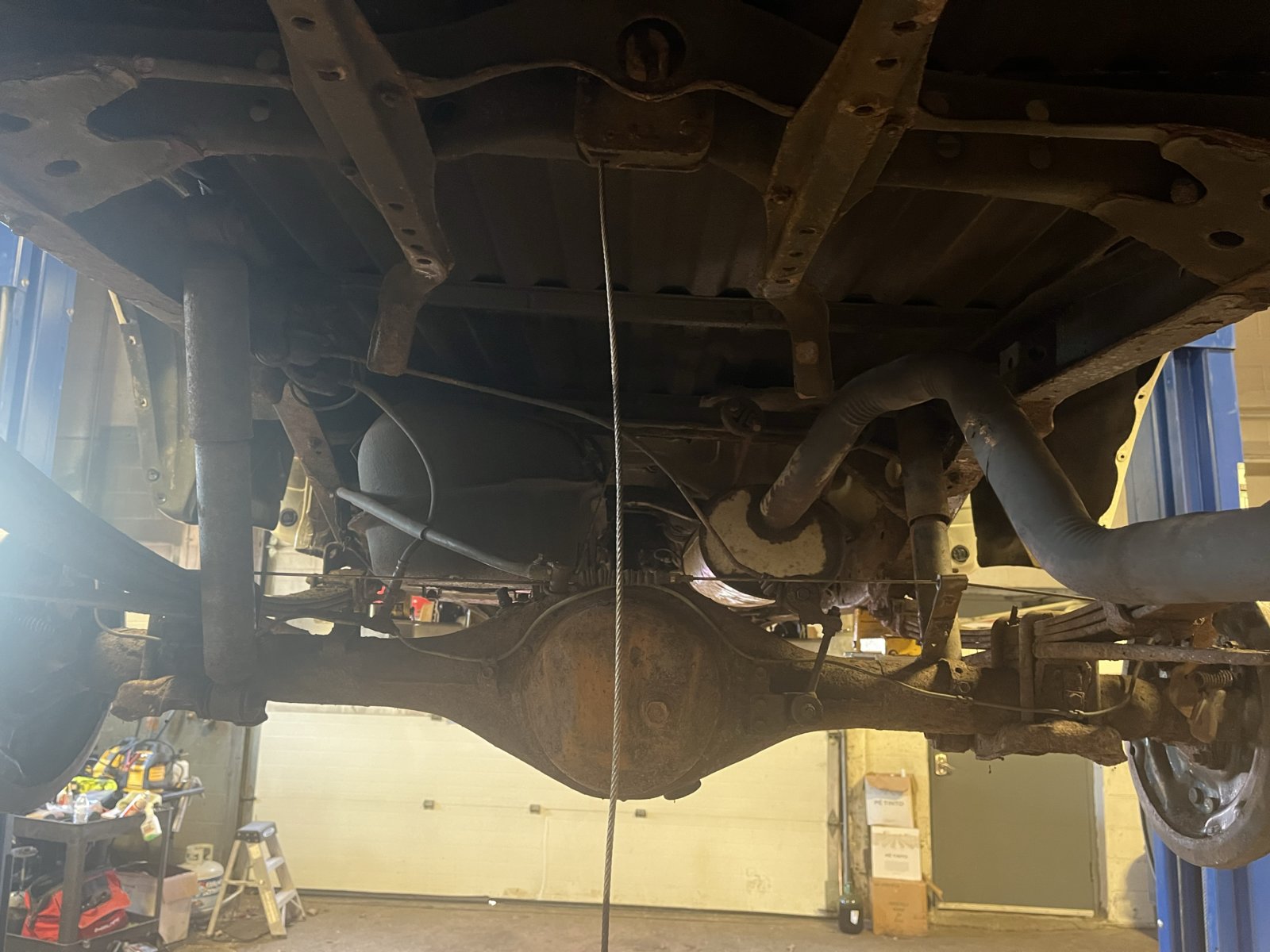

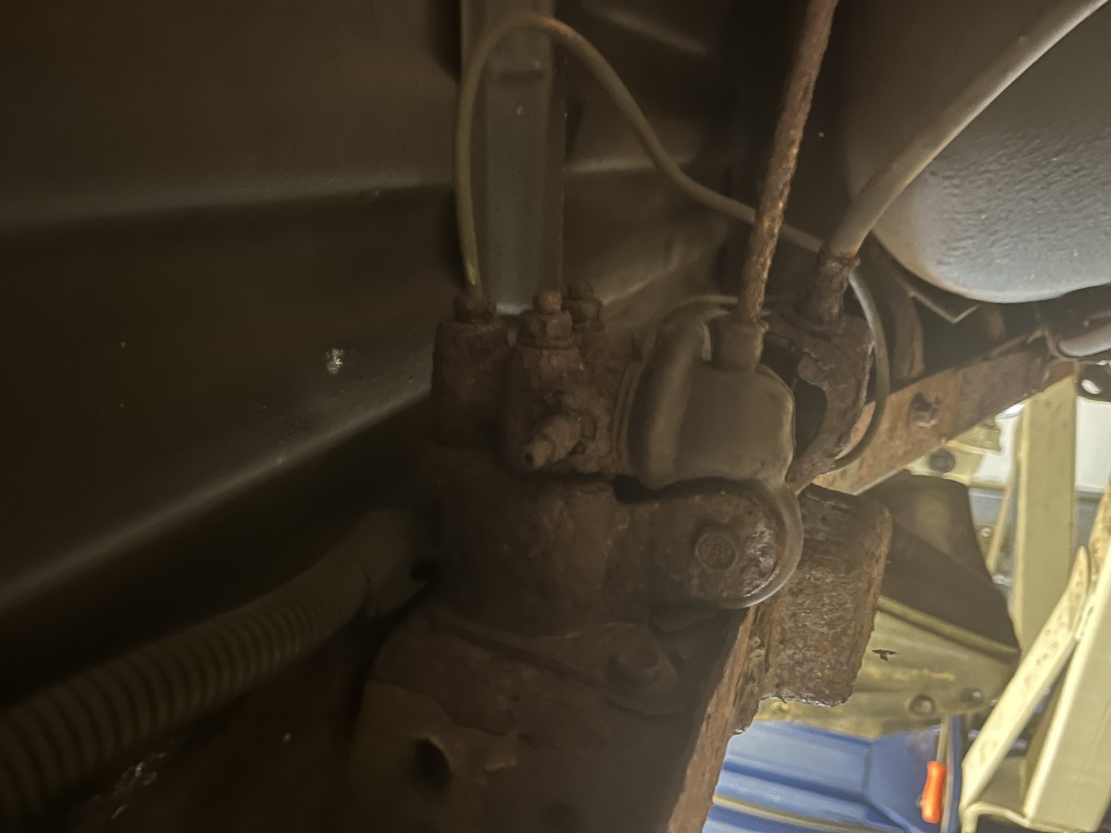

    I recently bought a Tacoma that I’m restoring, the actuator for the rear locker looks like it’s connected to the break line and I can’t find any information anywhere

    If the vehicle in your description is a 1994, it's definitely not a tacoma. Plus, there was no elock option in 94.

    Title says 1994 and it’s definitely not an e locker it has break lines going to the actuator that’s on the drivers side frame

    I'm not confused. Got a picture?

    Brake line comes down from the LSPV to a 3 way T before going to the drum on each side. What actuator are you referring to that a brake line will go into?

    It’s not a locker actuator, it’s a load-sensing proportioning valve. Sends more brake to the rear when loaded up. A brake pressure gauge can help you ensure its set up properly if you wish to

    Ok I found info on now it’s a load sensing valve! Thank you for the info
