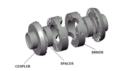

    6D8BDBA9-2C22-4E48-AD84-9F7054F42A5F-10996-00001A473FF6EF4D.jpg Ok the picture is a generic one but it is basically the same in our lockers. The couplers or side geasr as sometimes called has to line up in order for it to engage. You can see the shallow teeth in the joining surfaces of them in the pic. If you are driving straight forward or backward this will not happen. If you have one wheel spinning and the other is not then it should lock fairly quickly. However if you are approaching an obstacle driving straight that you need the locker for and have traction on both rear wheels try weaving the steering back and forth. Doing this should give you enough change in wheel speed between the rear wheels to allow the couplers to line up and lock
