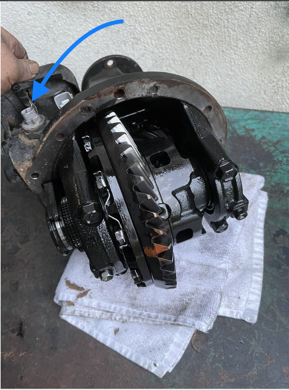

    OP, this is what you’ll be looking for.
    It is mounted on the rear differential.
    On the drivers side.

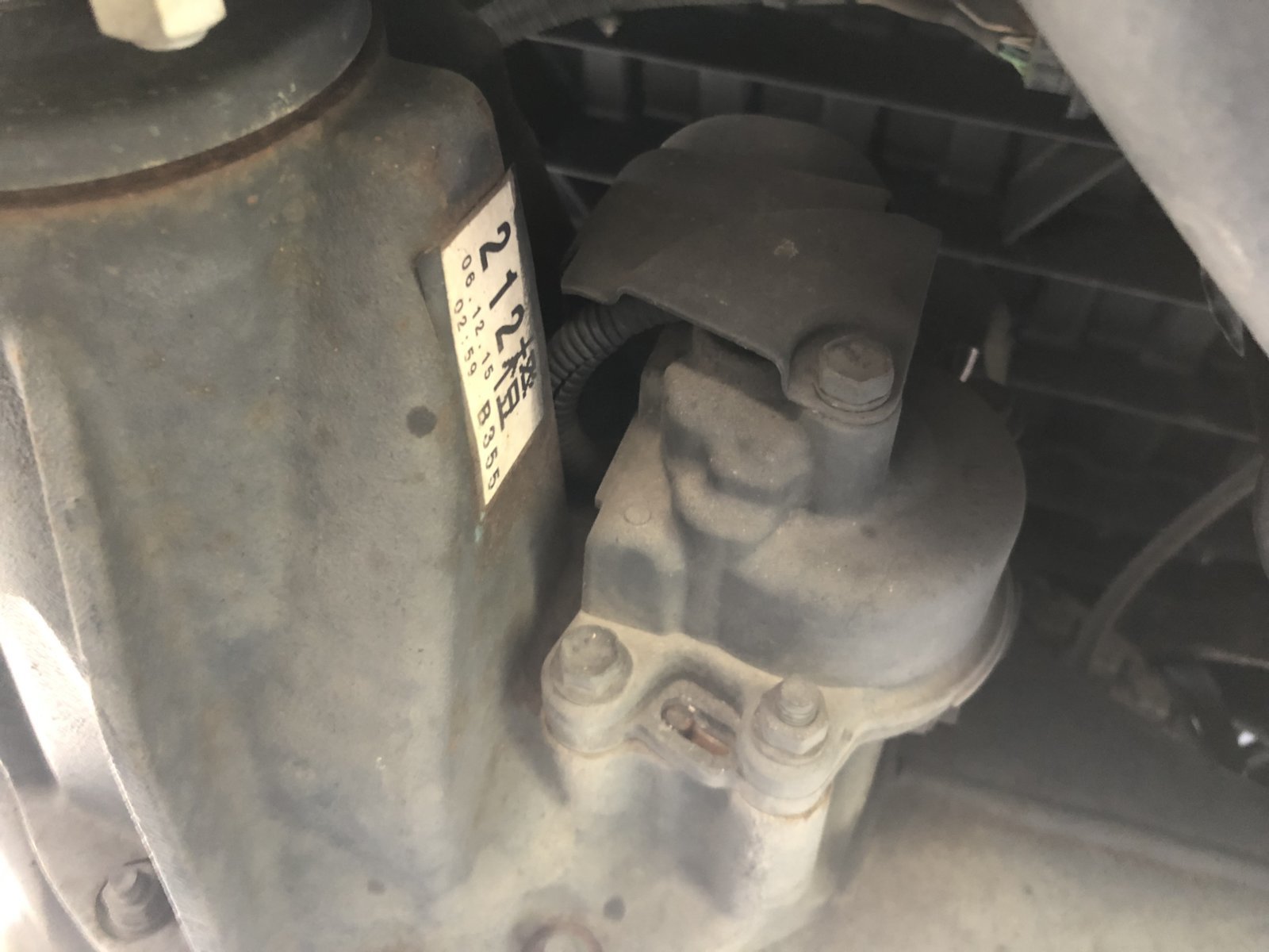

    It's got the locker, actuator is on the side of the diff. The guy I got it from was a donkey, cruise didn't work and 4lo wouldn't work, come to find out someone installed a nut on the top clutch switch to take up the slack and busted the other one ‍♂️

    It 100% has the locker, got home and put it into 4lo and hit the button with engine off can hear the actuator working but no light on the cluster or the switch itself, only got the green 4x4 light and orange 4lo light. Also just found out someone may have done the "locker anytime" mod. In 2wd I pushed the locker button and can hear the actuator. Maybe ill try going on a dirt path and see if the light comes on
