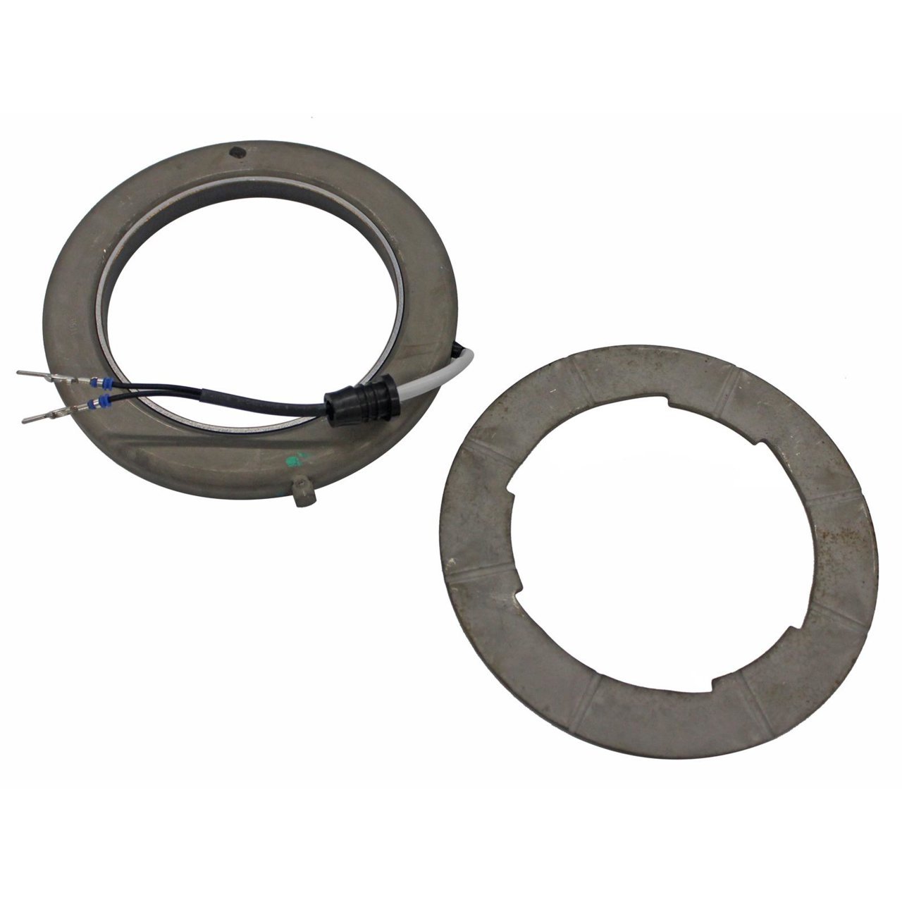

    The locker on the 3rd gen, unlike the 2nd gen, has no external moving parts, so should resist getting sticky. It is a solid state electromagnet, in the form of a coil, that, when energized, pulls a metal plate towards it, engaging a dog clutch. The whole assembly is bathed in oil and constantly in motion. It’s extremely simple and reliable, and will work until a mouse chews through the wires.
    (thanks @Ozarklander for clarification on this)
    For the locker to operate, the clutch must align when the magnet is energized. It cannot do this if the wheels are stationary, or not moving in opposition to each other. As others have said, you gotta move forward and slightly steer. If you are already stuck, it should be easy to get one wheel spinning, which will allow the locker to lock.
    In rare circumstances, everything is perfectly lined up and the locker will go in right away, however, I have only had that one time out of dozens.

    You are more describing the Eaton e-locker mechanism and not the 3rd gen factory locker. The factory e-locker contains no ball/ ramp mechanism and just a cam ring that engages a simple dog clutch. These dogs are all that have to get aligned.

    Ahh. My Toyota mechanic told me the 3G locker was nearly identical to the Eaton e-locker. I guess he just meant it had no motor or worm gear. Still, most of what I said is still true. Thank you for clarifying.
