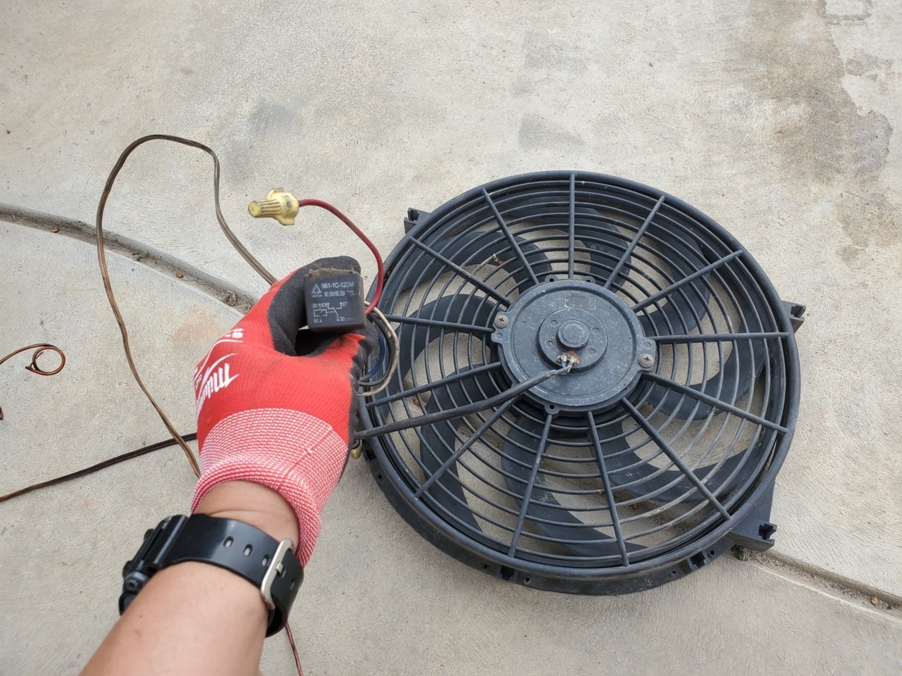

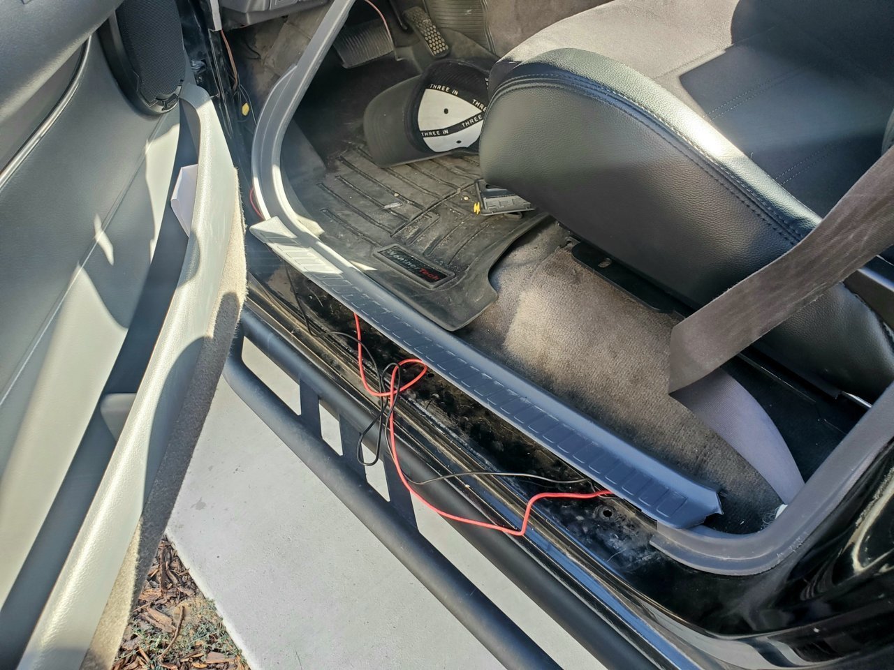

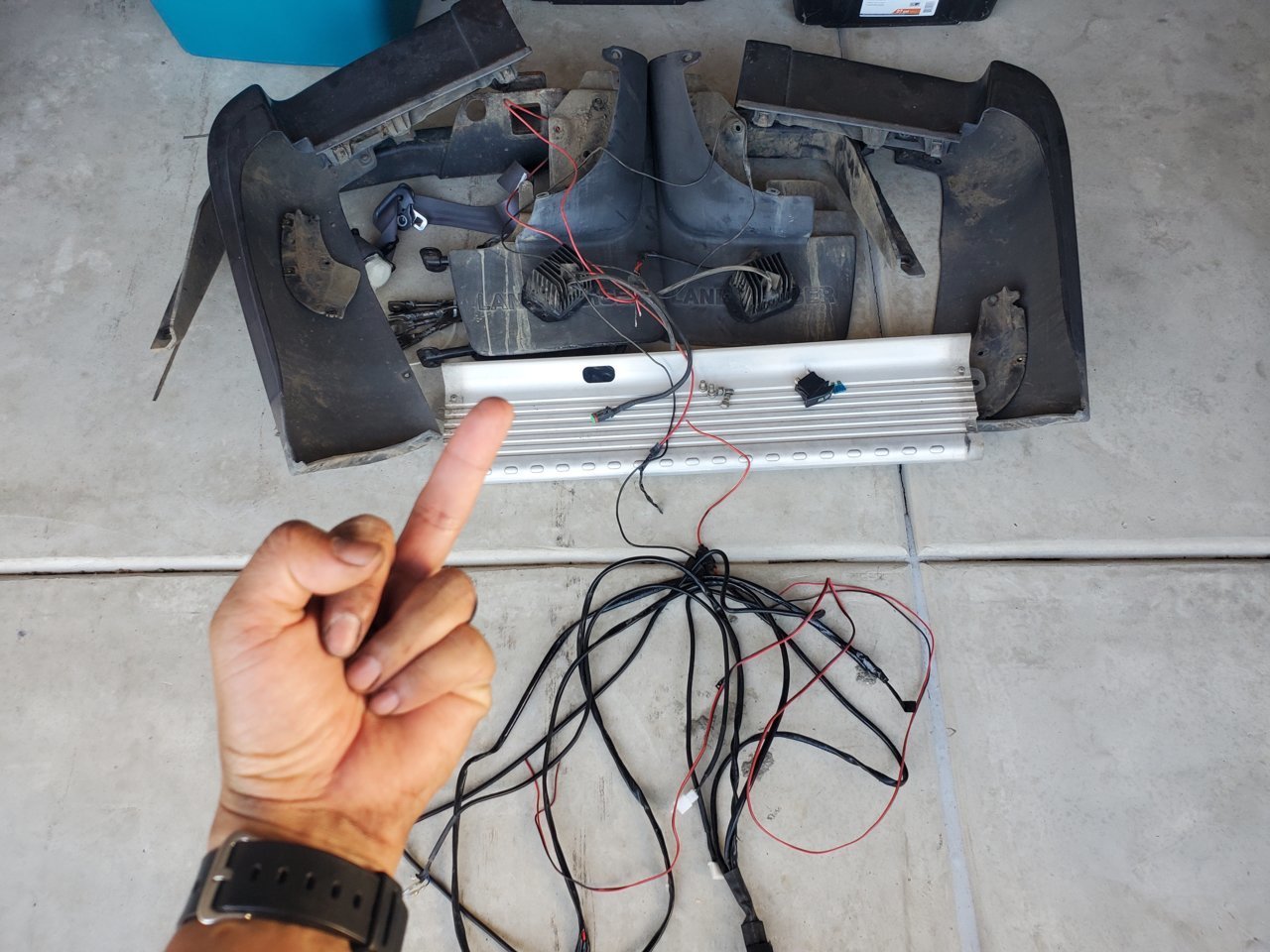

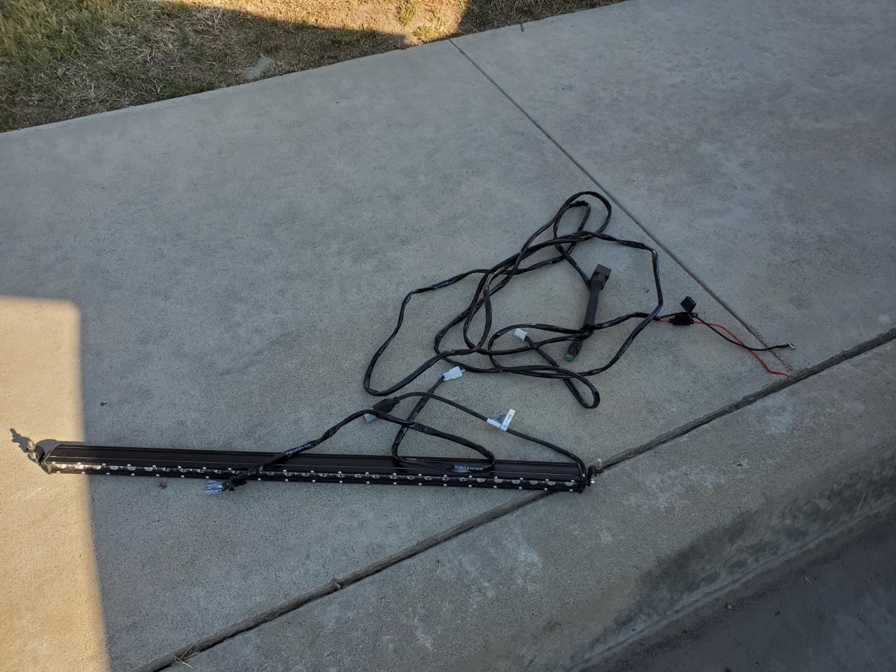

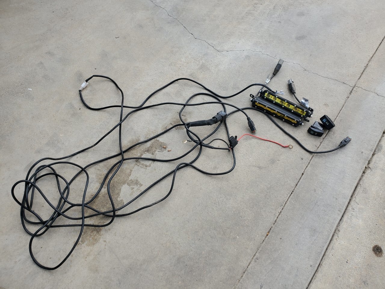

    Just an example of shit I uninstalled in a short time frame from my vehicle; all done by the previous, or previous previous, or even more previous than that, owner.
