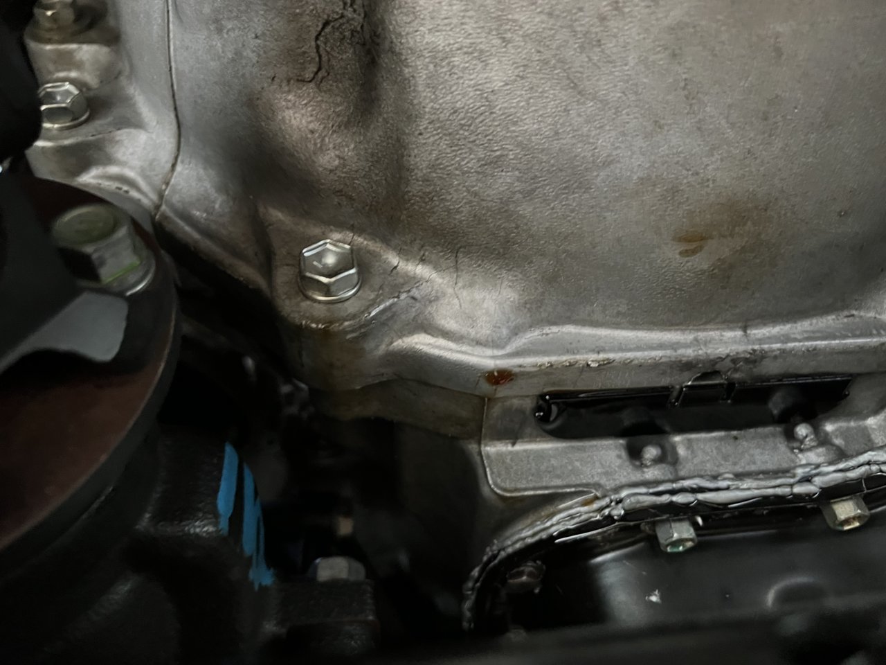

    Yea, that's leaking a bit much if the oil on that cloth is only after a 15 minute drive. Personally, I'd get it fixed.
    It's clearly a class 2 from the pics and if it's like you say after that short of a drive, I'd assume you are seeing spots where you park as well.

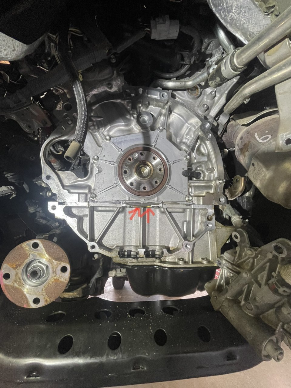

    BF0F8545-E7AA-4B9F-9846-0AA6F32526CD.jpg Hey guys,
    At our shop. We’ve seen quite a few of 3rd gen taco with rear main leak. The actual leak comes from the rear main cover, not the seal.
    We reseal the cover and replace the seal.
    Please see attached picture.

    I beg of all techs to re-seal the plate during the install, it takes 10 mins.
    We learned of this during the 5.7 tsb, lots of rear main plates on those.
