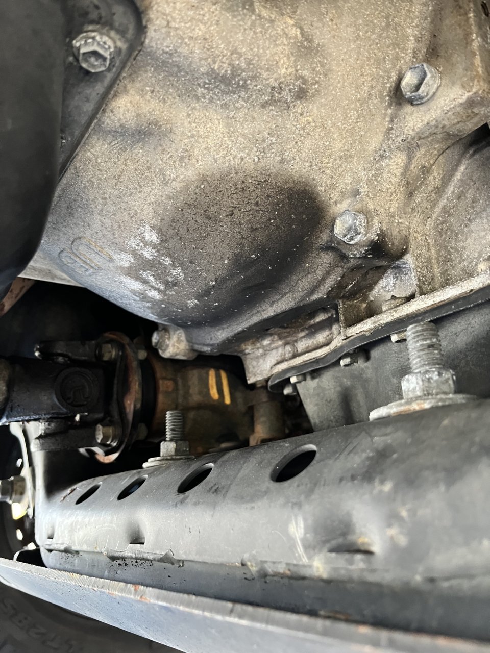

    Thread revive

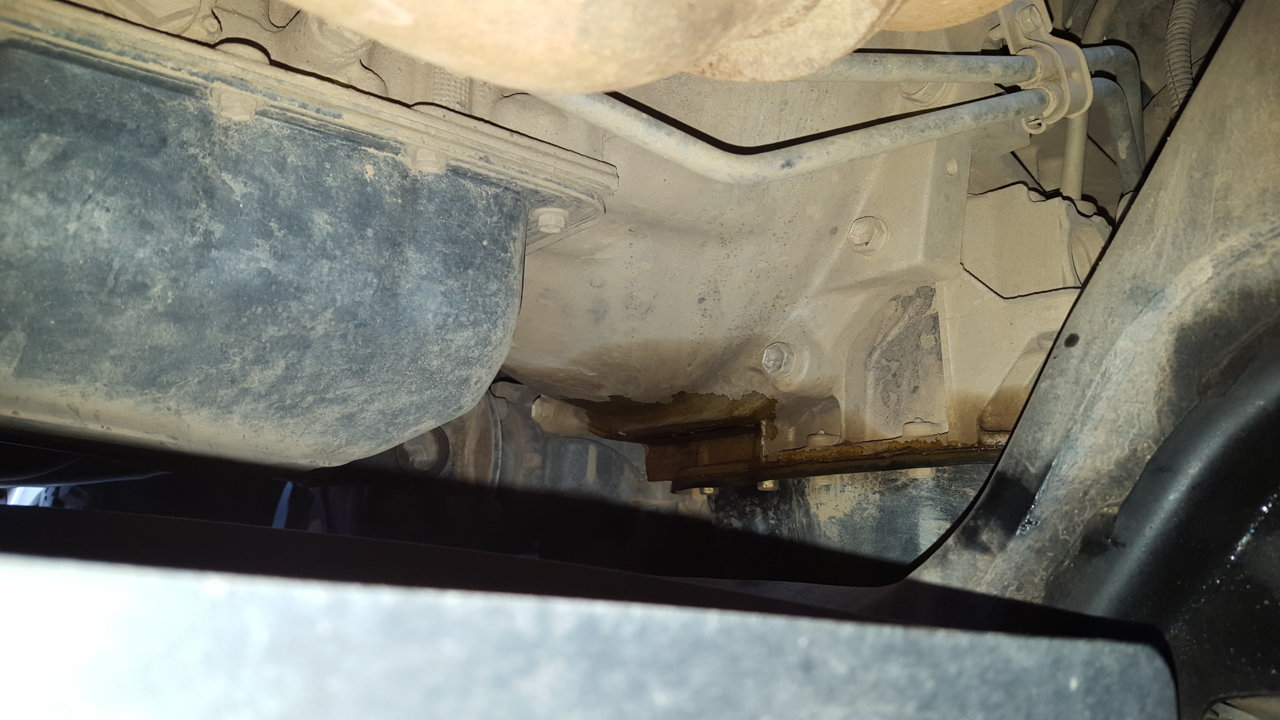

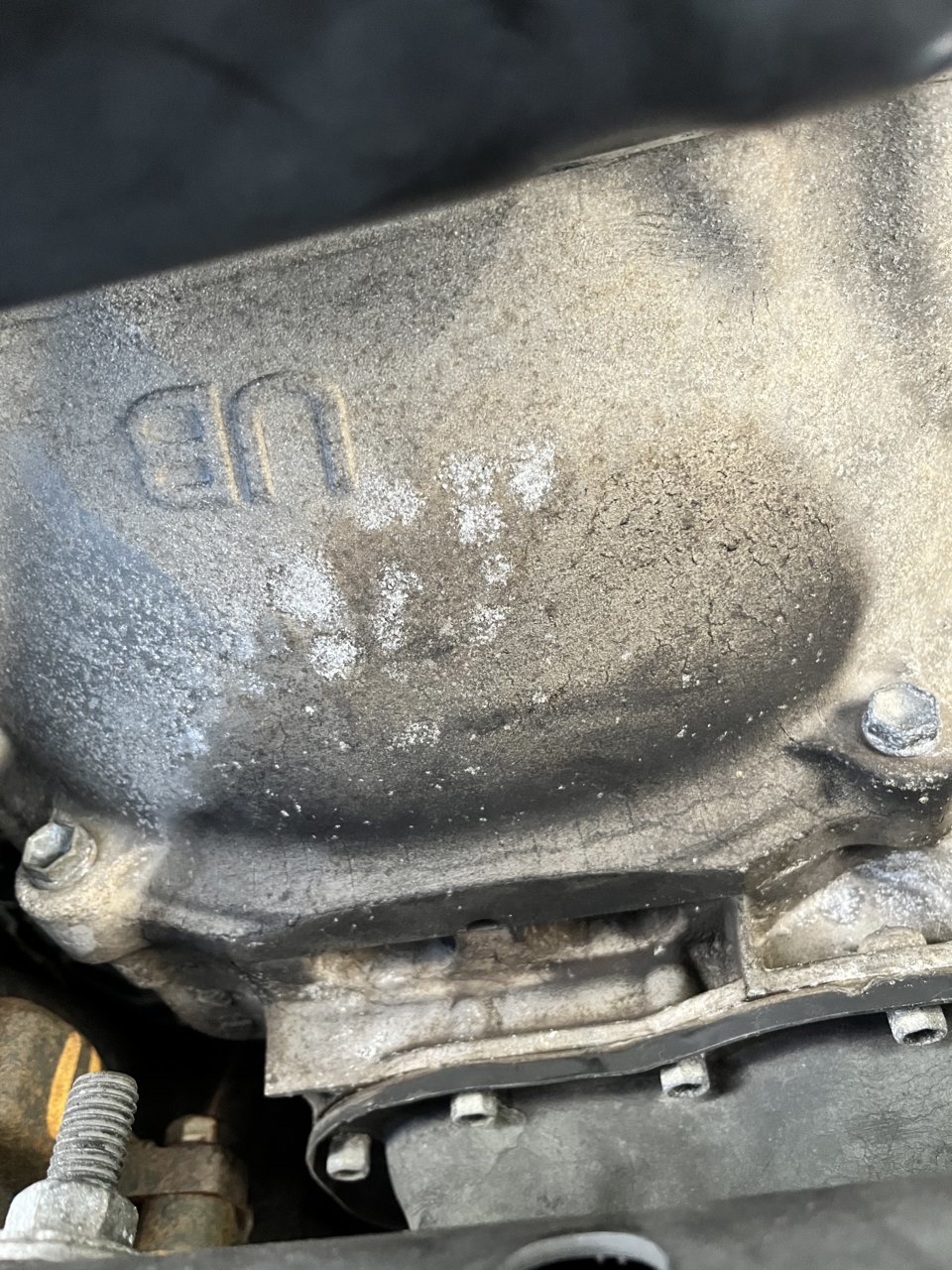

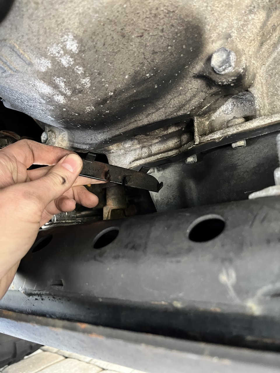

    was taking off skids to eventually do my transmission fluid drain/fill
    noticed mine too except it’s pretty dry even when I take the little plug off.
    makes me wonder if this is just grease from the u joint spinning and slinging it over. Very hard to tell as there isn’t any “oily” mess or anything so maybe a very slow leak or grease sling ‍♂️…..thoughts ?
  17. Nov 23, 2022 at 10:49 AM

    I’d have to crawl under mine and take a look at where the joints are. But I don’t remember that being a spot where grease is slung. I won’t be home for a few hours. But I’ll be happy to crawl under mine and see.

    Exterior: -Current Suspension- Icon extended travel front struts w/ 700lb coils Icon extended travel Remote Resi rear shocks Dakar leaf pack Icon Tubular UCAs with covers Icon neoprene shock covers -OEM Roof Rack -2 fold down cup holders in bed -Bed bottle opener -Access lite rider roll up tonneau cover -AFE Prodry air filter -Pop and lock bed lock -Rear differential breather relocation mod (behind tail light) -Aeroturbine 2525XL Muffler Armor: -SOS Concepts bolt on sliders W/ kick out -SOS Concepts aluminum front bumper with full hoops -SOS Concepts Rear HC Bumper -SOS Concepts IFS/Mid skids
    thanks…

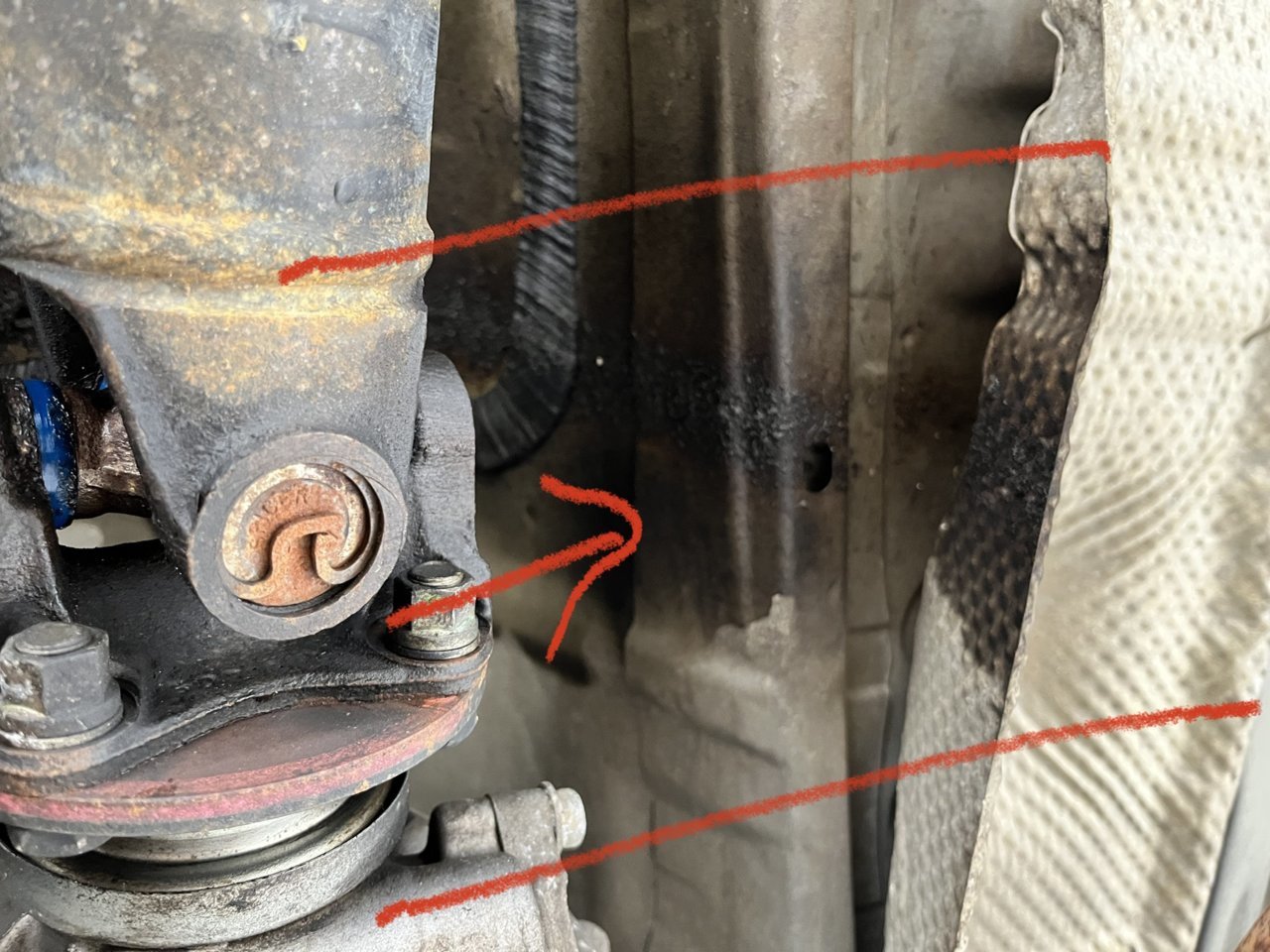

    I cleaned it up with brake cleaner and will also just keep an eye on it.
    I was just assuming grease since most my other joints seem to sling in a similar pattern.

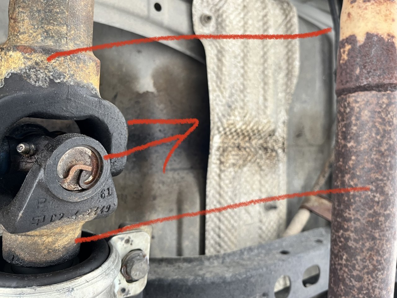

    Here is a few pic of my other joints and the grease sling….I at least hope this is all it is :)

    Yeah,I’ll take a look.
    Mine has grease sling too.

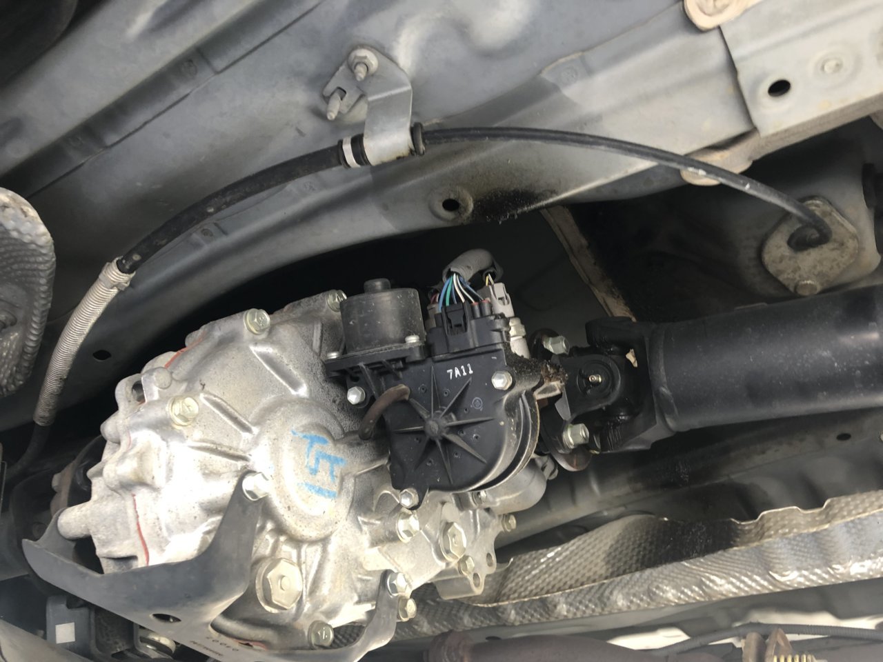

    I had this picture I took for some reason on my phone. You can see the sling line pretty good. It gets on the actuator, but I never had any problems. So I don’t wipe it off.

    Mine doesn’t show the grease there.
    It’s further back.
    I did see, that is the zerk for the front driveshaft. The front driveshaft doesn’t spin unless you are in 4WD.
    I don’t drive in 4WD often, and when I do it’s slow.
    I don’t think what you are sing is a rear main leak. I don’t see enough evidence of one in your picture where you pulled the inspection plate. I’d expect it to more wet.
    If say you don’t have anything to worry about. I’m betting it’s grease.
