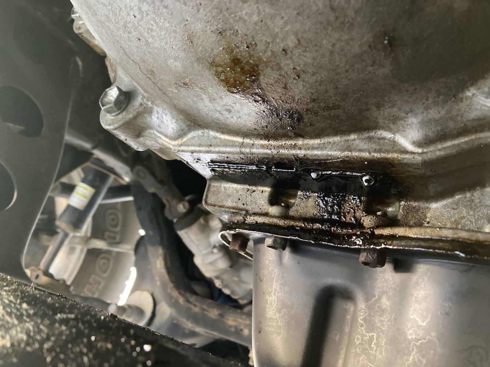

    2017 truck, 2wd, auto, V-6, 90,000 miles, basically passenger use.
    The rear main seal is leaking (new PCV clean lines etc... it's the seal!)
    Anyone else have this problem? Any chance Toyota will come to the rescue? I've have 8 other Toyotas most over 200,000 miles and never a basic problem like this. This is not typical Taco stuff!
    Am I missing something?

    No, Toyota typically only does goodwill for a max of 1 year or 10,000 miles over. Drivetrain is 5 year 60,000 miles.
    2WD makes it slightly easier to do, but yours is definitely bad enough to change sooner than later.

    So what's a 'reasonable' estimate for this job? 8 hours?
    You can just pop a new seal in, right? I've got the time, but I'm not sure I have the energy. This is so fokin' wrong too be happening at 90K

    Don't waste your time. The warranty is 5Y/60K, and you agreed to those terms when you bought the truck. If you were a few thousand miles over...that's one thing. You're 40K miles over. It ain't gonna happen.
    Just cuz it says Toyota on the side doesn't mean they'll fix it for free forever.
    Find a good independent shop, ask that they use an OEM seal rather than aftermarket. 2WD...I'd say 8 hrs it a bit much....but it all depends. Those oil pan bolts look a bit rusty, so they exhaust fasteners are probably rusty-er and might break. I'm guessing you're close the water in FL? Book time kinda goes out the window unless the vehicle is basically in "like new" condition.

    I’m not a dealer tech and I don’t ever get work done there so I have no idea what the normal rate is for a job requiring transmission removal, but 8 hours seems about right to me based on me pulling transmissions myself.
    Unfortunately RMS are semi common on this engine. Seemingly more common than other engines I’ve observed that have 1-piece seal designs, which are far more rare to leak than 2-piece designs typically. I don’t know why this one has seemingly more reported leaks. PCV is usually the cause but you’ve already addressed that.
    If you can pull a transmission then you can do it yourself. That’s what I’d opt for, but I can understand why others wouldn’t want to. I would use an OEM seal.
    Hopefully your crank isn’t scored in a way that will cause the new seal to leak too.
