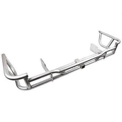

    trying to see if anyone has any good pics/ideas of mounting pods for night lighitng and or reverse. id prefer to use them as just night light option so i wouldnt have to be in reverse the whole time. this time my rear bumper and id like to wire them to the left and right rear farthest on the outside of the bumper

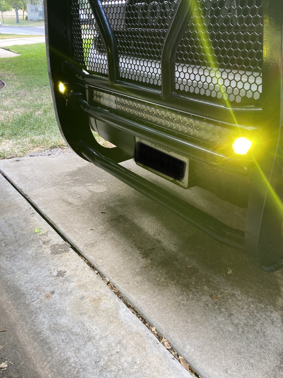

    You don’t have to drill. You can buy mounts for tubes
    I’ve done it to my tundra

    I’m using ones just like that

    Diode dynamics has a backup pod light kit that’s backlit red, using 1” or 2” lights. You can probably fit that
    i don’t know if it’s worth it to make a drain hole

    If it's still welded shut I wouldn't compromise the tubes.
