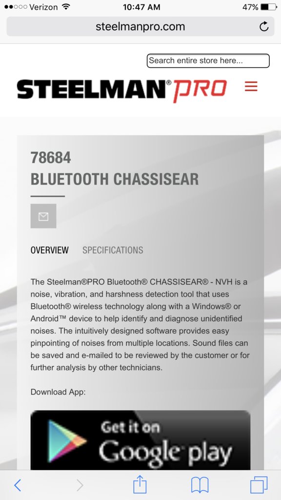

    The best way to solve rattles that are hard to find is eliminate parts one by one. I use this tool and love it.
