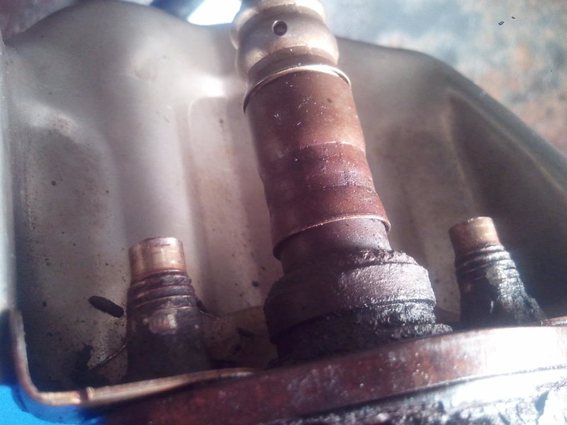

    Nuts are almost rusted off and not to sure how I should proceed... any ideas?
    Thanks

    mine were the same way, look at the original post as to how I got them off with a special Craftsman tool, good luck
