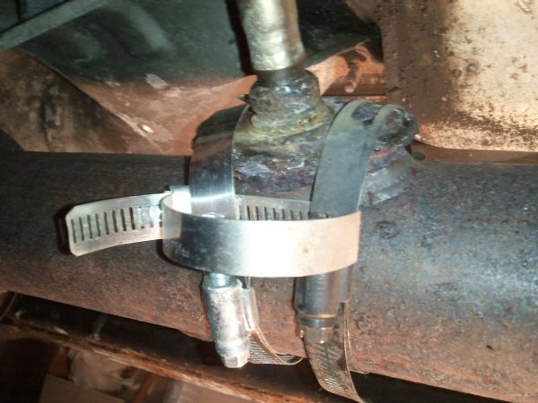

    My '95 3.4l has JBA headers and exhaust. Whoever installed the system buggered the mounting of the rear O2 sensor. This is what it looked like when I got it:
    I figured there wasn't much I could do about it, so I just left it alone. Shortly thereafter the front O2 sensor failed. I replaced it and all was okay. For a day or so. Then it started throwing the infamous PO420 code.
    I decided to install URD's O2 simulator. It solved the problem and all has been quiet. Until a couple of weeks ago.
    While driving I noticed the exhaust suddenly was louder. I took a quick look and saw the rear O2 sensor hanging by its wires. (No CEL because I am running the simulator)
    So I got underneath and did a quick fix using hose clamps:
    This is not an elegant solution of course. But I'm wondering what exactly would be the best fix for this. I don't even need the O2 sensor. At this point it is merely blocking the hole.
    I'd appreciate any thoughts you guys have?

    Any fab machine shop or muffler shop for that matter can just weld it shut if you don't need it, or contact jba for a replacement piece to keep it in place for emissions.

    Got to a local exhaust shop and have them fill that hole and weld in a new bung beside it

    Yeah I'm tempted maybe to just weld it shut. Can always be restored later if needed.
    And removing the O2 sensor entirely would lessen what little resistance to flow its presence creates. I dunno how much of a factor that is tho...

    Hey thanks Dirty Pool. I didn't realize that. If I had, I would have secured the thing sooner from swinging in the breeze like it was.

    You've got a couple options, depending on the condition of the rest of the pipe.
    *Weld a new O2 sensor directly into the pipe
    Pros-
    *It won't come out again
    Cons-
    *Weld a new stud to the old pipe
    Pros-
    *Factory-style O2 sensor still bolts on properly
    *When the pipe itself fails you can salvage the sensor for reuse on the new pipe.
    Cons-
    *It may take several tries to get the new stud lined up with the bolt holes on the sensor
    *The pipe may not be thick enough to take the weld and will burn through
    *Buy a new pipe for the new O2 sensor to mount to
    Pros-
    *New parts! :woot:
    *Direct bolt-up, minimal headaches required
    *Won't need to worry about the pipe or the sensor again for years
    Cons-
    *Expensive
    *Won't match the rest of your current rusty pipe.
