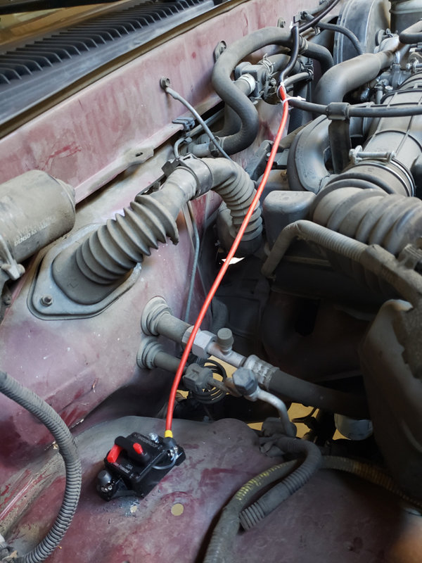

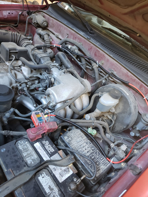

    phase 1 today, engine area. 30amp breaker housing broke while i was drilling its mount hole so i have a new one ordered. I also don't have enough 10awg for the ground so ordered that, same gauge. also dont have a 30a fuse for the battery post extender i added to clean up the mess I had there, so ordered those. Ran wire from battery to breaker and zip tied and added outer shell.20210109_144658.jpg 20210109_144707.jpg

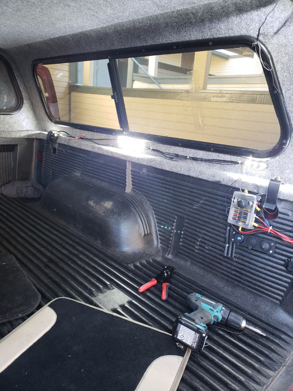

    went a little crazy with my dremel and cut the rectangle a little too big but easily hacked. also wired the relay switch in the cab to the battery.

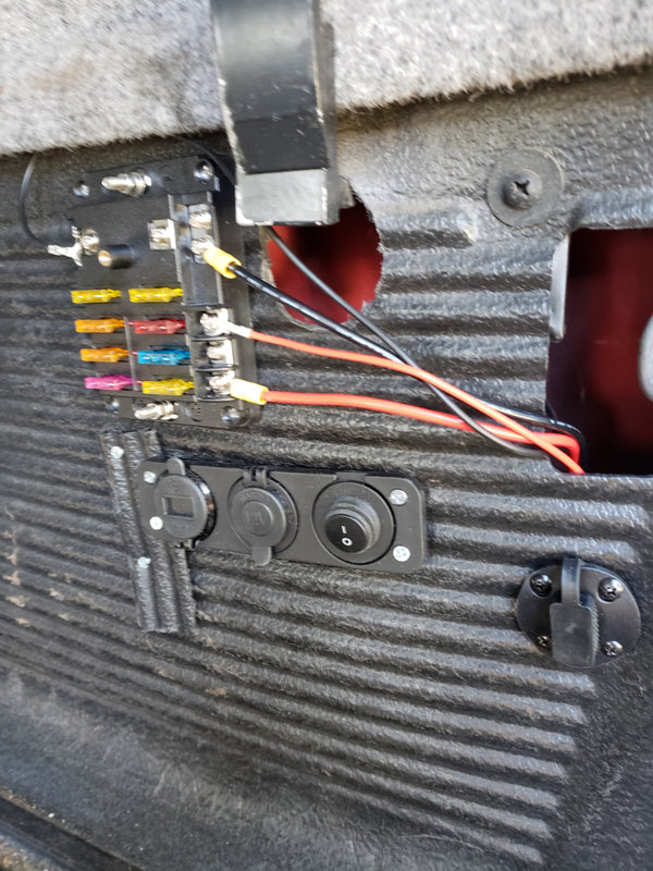

    todays work:
    Run wire from bed to cab. spend an hour trying to get the wire into the split wire cover.
    connect breaker from engine to relay
    wire all 4 connections on relay.
    Wired dash switch backwards, spend 15 min testing which wires go where.
    Connect fuses at battery
    Test back panel, all good.
    turn on USB panel, no power.
    pull out USB panel, connection came off, reconnect
    reinstall. still doesnt work, reverse wires, works fine. reinstall.
    test brake lights after, left side brakes are not working. hit them, they work. disconnect, check socket, refit and they work. reinstall and they dont work. reverse LED bulb in socket, they work again. Ugh.
    0xDEADBEEF likes this.

    Make sure you tape over those holes in the plastic bedliner. Dust is going to enter through those holes if you do some driving over dirt roads.

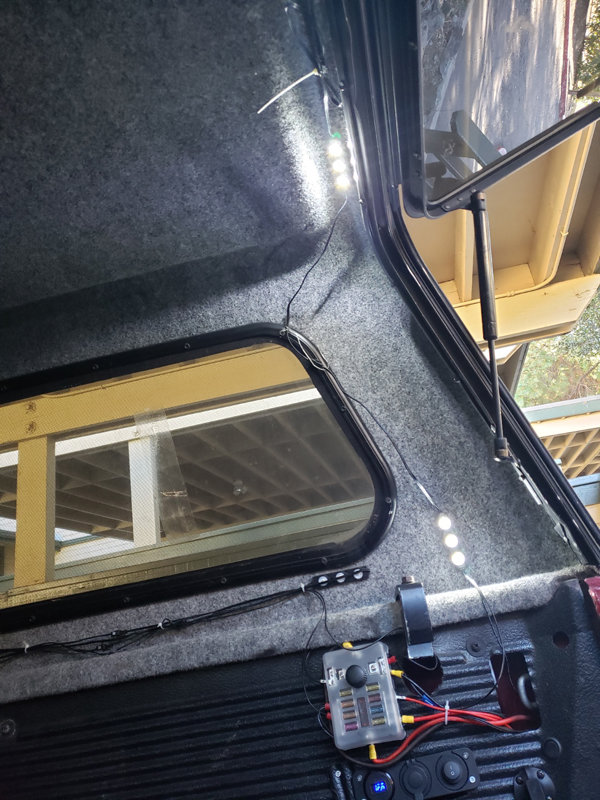

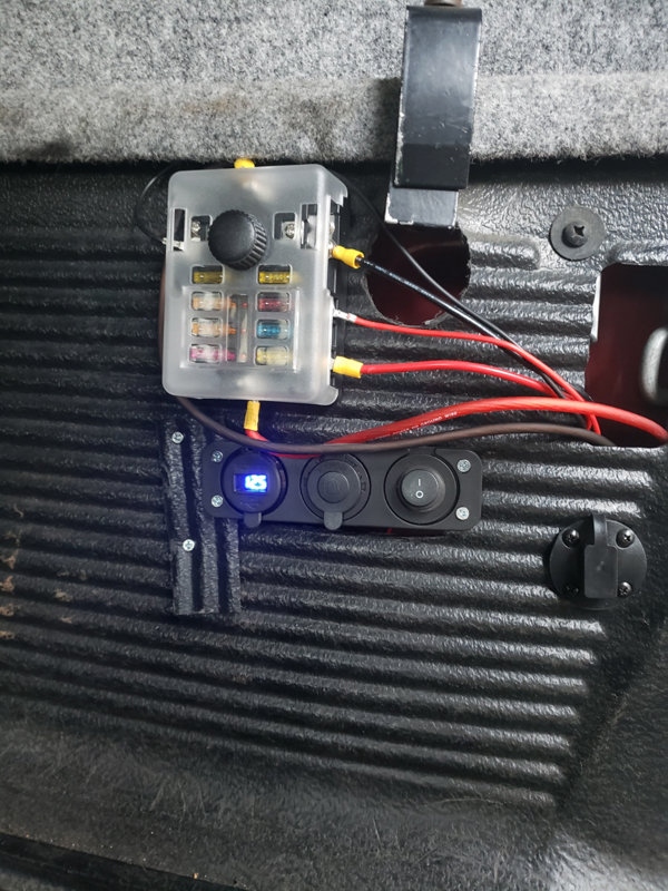

    all done, but im sure the tape wont stick to the carpet lining very well so I may velcro them later, but everything works. Switch for the top ones is near the tailgate, switch for the side ones is near the cab for when i sleep.
