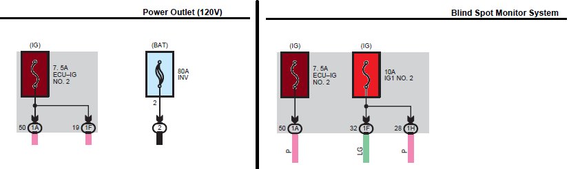

    Crap, totally lost track of this. Sorry about that.
    I *did* check the fuse, yeah. No issues there. I also tried to temporarily hook the wiring back up from the broken bumper, and it didn't seem to make a difference. Though the blind spot monitor computer is destroyed, so I'm not if something else is going on there or not (if it does require something in the rear harness anyway).

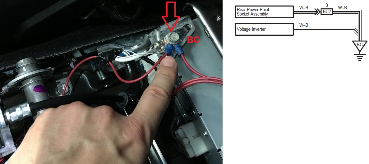

    The Voltage Inverter and the Power Outlet share the same Ground.
    What I don’t know is, where it’s located. Maybe @caribe makaira has location diagram?
    Do the lights for the inverter on the switch work?
    And have you checked all the associated fuses?
  6. Jun 20, 2021 at 4:02 PM
    caribe makaira
    caribe makaira Well-Known Member
    Feb 13, 2011
    #51121
    11,786
    Caribbean, Puerto Rico
    05 PreRunner TRD Offroad AutoTrans
    Hood Struts, My version Fogs always ON, Map & Overhead Light Mod,
    It's right next to the inverter, floor board.

  7. Jun 20, 2021 at 4:06 PM
    TnShooter
    TnShooter The TacomaWorld Stray
    Sep 2, 2010
    #42625
    21,296
    Deogee
    07' TRD Off-Road, Auto
    STOCK
    Thanks :thumbsup:
    I’m going to guess, this isn’t his problem.
    Since it isn’t associated with the rear bumper or harness.
