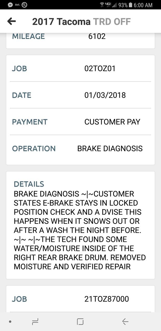

    Working now a list
    This is what they told me.

    That wont solve anything, A drum brake isn't exactly sealed. My 2nd gen did this sometimes, Low range and some throttle would break it free.
