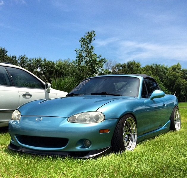

    You can always just lower it and roll the fenders around the tires... Fixed the same issue on my Miata that way! Still handled off road pretty well as you can see.
    Might not be the solution you were looking for though...
