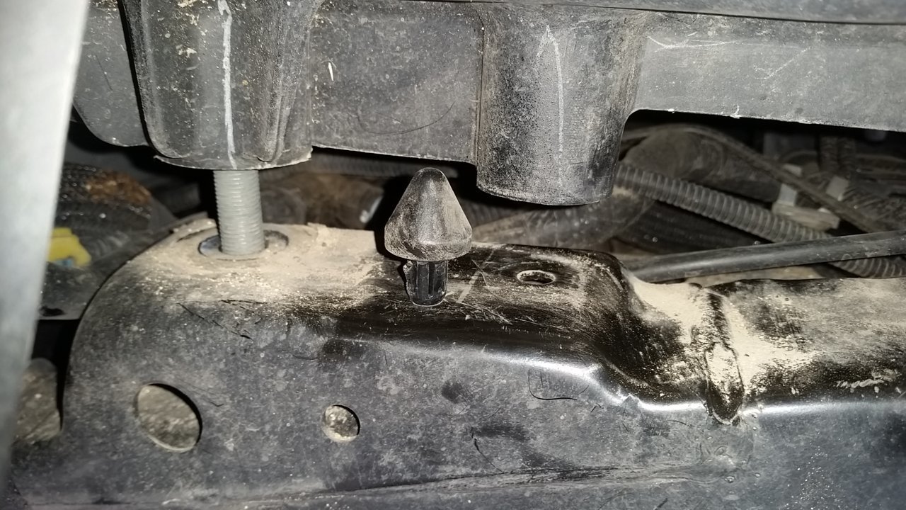

    @tandemgeek @trazerr Success!
    Keep in mind I'm no mechanic in any sense of the term...I started off loosening all the bed bolts. Then I got under the truck and found the fuel filler neck bolt and bracket (and loosened), but could not find the bed alignment pin. At least not like the one in tandemgeek's photo that is mounted to a bracket. But rather it is mounted into the frame. As the bed is lowered onto the frame, the pin seats into a plastic (pillar?) the same plastic pillars that the bolts from the bed thread into;
    You can see in the photo (the bed is lifted and supported above the frame) the pin is popped out and now sitting next to the hole in the frame where it was mounted. The pillar above the pin has a "dimple" that it seats into. You can also see the bed bolt coming through the pillar next to them. So I popped that pin out preyed the bed over, re-tightened the bed bolts and fuel neck bolt and now my OCD nerve is spared...From this at least! Thanks again for all the help yall. Even @ICU1 which I'm in the process of doing now:cheers:

    Yessir it is a short bed. I didn't think about that and I read through your blog on the process...:frusty: Oh well, it still worked and your documentation was the push I needed to get under there and fix it! Thanks again bud:bananadance:Cheers!!

    It really wasn't a hard fix at all. And I'm no car guy... Loosen some bed bolts, a fuel neck bolt, raise up bed and pop that alignment pin out. Then bitch slap that puppy into submission!

    Now that you’ve aligned the bed to the cab, did you check the cab first? o_O
    My 2017 had the same issue, and Toyota had to align the cab first to the frame before matching the bed to the cab, else they would have both been off. I only found the issue when I tried to put a shell on it, there was no way to match it to the cab.

    Right on! Be sure to read through @tandemgeek 's blog and cross reference with my photo if you have the short bed. Good luck!

    2017 TRD OR
    Thanks! Will do. So you just left the pin out, right?

    In my case I adjusted the bed to the axle. I did put a tape measure on the back of the cab and was spot on both sides. It was a minor adjustment to make up that 3/8" closer to the rear of the bed.

    Correct!
