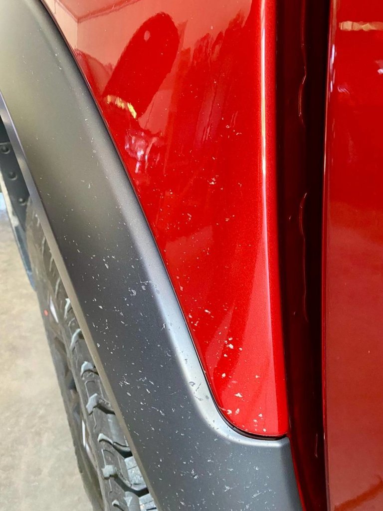

    As others mentioned, it's a symptom of flared fenders, not unique to the TH or bed length. A guy on the Ranger6G RR forum took off his running boards, drove like 50 miles on gravel, and his rear fender and bed are obliterated at the same place. One of his pics below.
    Everybody over there who doesn't want it is saying the same: keep the wide running boards on, get mud flaps, and don't run spacers or get new wheels with offset that defeats the flaps. Luckily, the OEM RR ones look decent. The guys getting RokBlokz say those ones are very pliable, and will easily fold/bend without breaking when offroad. Keep in mind RB specializes in rally mods. PPF only will be shredded.
    The other thing to keep in mind, is some of these newer aggressive A/Ts just seem to catch and fling rocks like crazy. E.g., BFG KO are notorious rock chuckers.

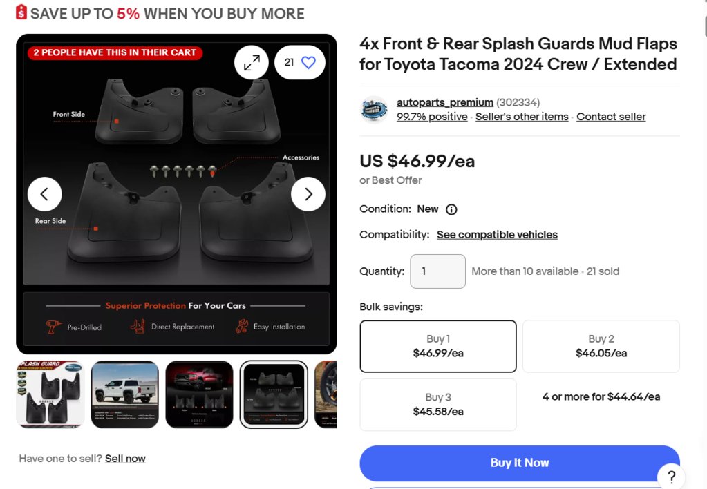

    This is the solution. Very similar to a rally car set up. Even on my 3rd gen the sides started to get pounded from high speed gravel. I'm also faced with upper midwest winter salting/sanding attack on the frames. (salt/sand ruined two of my past gen Tacomas with frame rust failures). I also run higher speed (50 mph+) smooth gravel and dirt roads out in WY, MT, CO and UT while in 4-HI. My solution was larger flaps made from flexible rubber material that still can perform offroad without ripping off. You won't fit the insta-gram image but you will definately save the exterior paint finish and prevent the majority of winter salt instrusion. Summer months I just remove them unless I'm headed for high speed gravel roads in the western states.
    461102749_10230040883339119_725910187635_ca119923639a94dcd37406e76d029356c45dffe5.jpg
    another option, a bit more expensive and with a size selection, but may look better
    https://rekgen.com/collections/rek-.../products/rek-mesh-universal-offset-mud-flaps

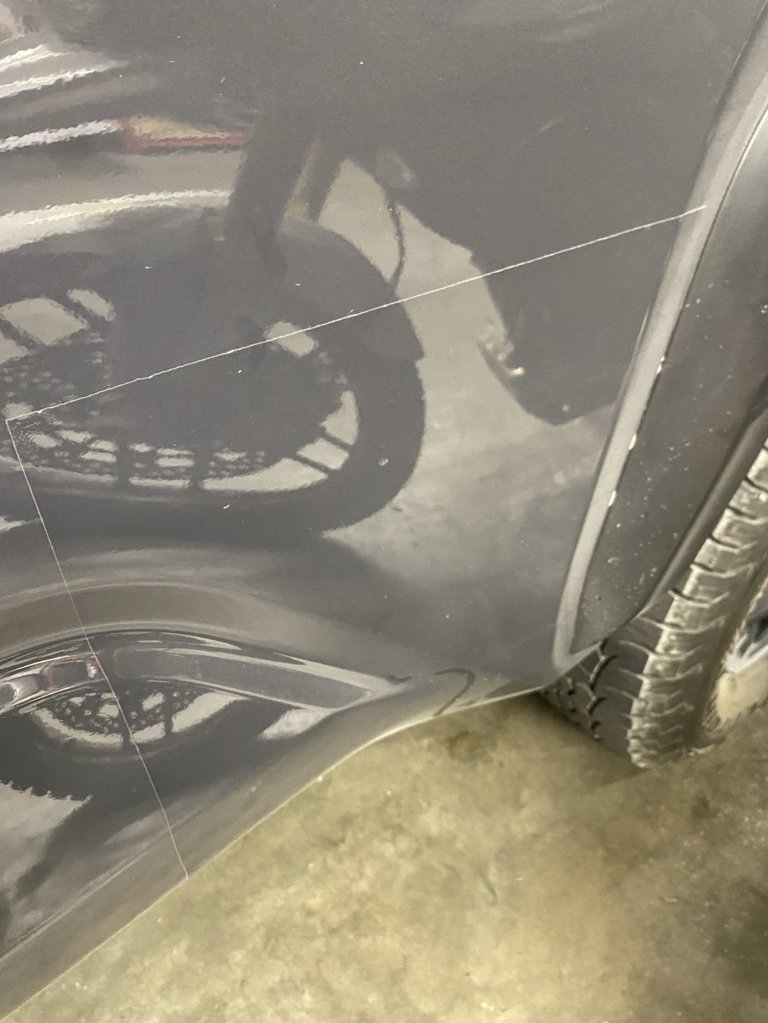

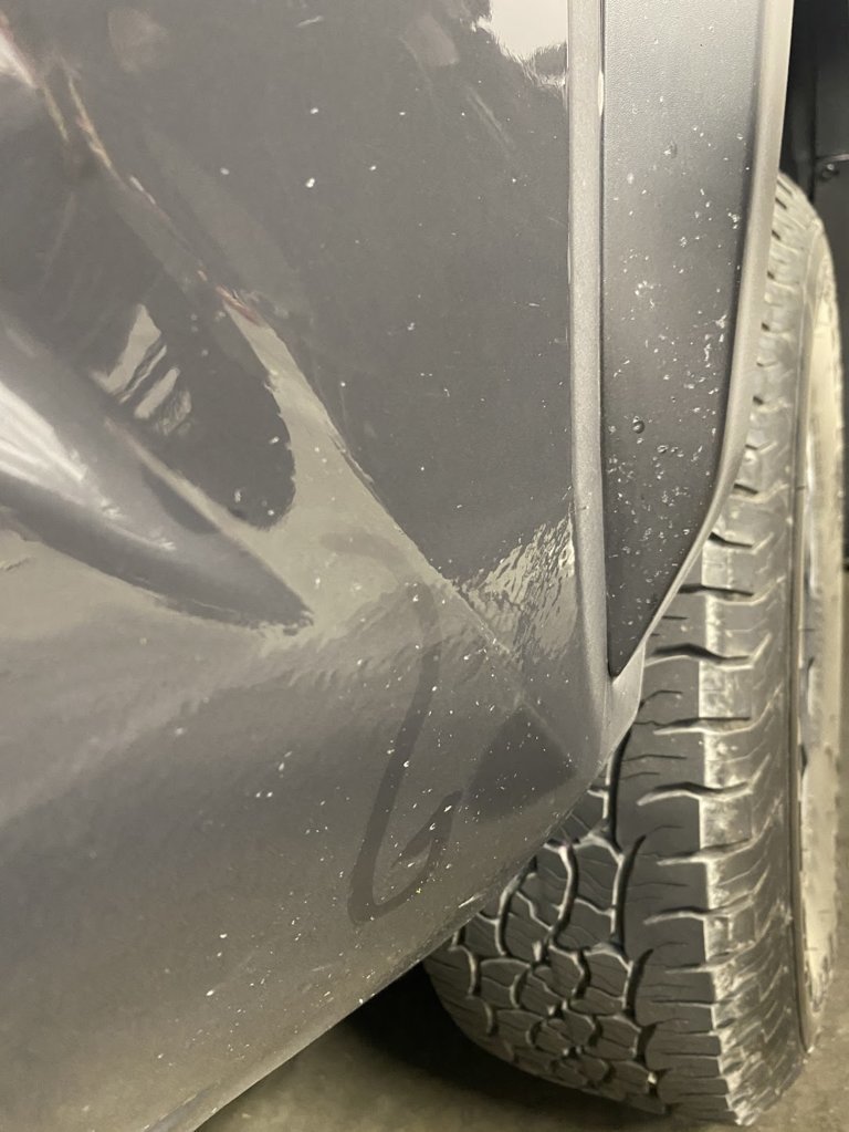

    So I did a pretty fucky DIY PPF job on this. First time and looks every bit of it. The truck is dirty so you see that chop line on the top. But I went just to where the fender flare starts to curve. It's really only about the first 6" of the fender flare, measured from the bottom. Doing the whole side in PPF would just be wasteful. Getting the PPF into the curves and groves is a real pain in the ass. This is most a pavement princess truck I drove about 100 miles on gravel with. Some of the rocks actually tore holes in the PPF. And this is with those gargantuan ark mud flaps.
    This is a close up to see how buttsmashed the flares get after just a bit of gravel:
