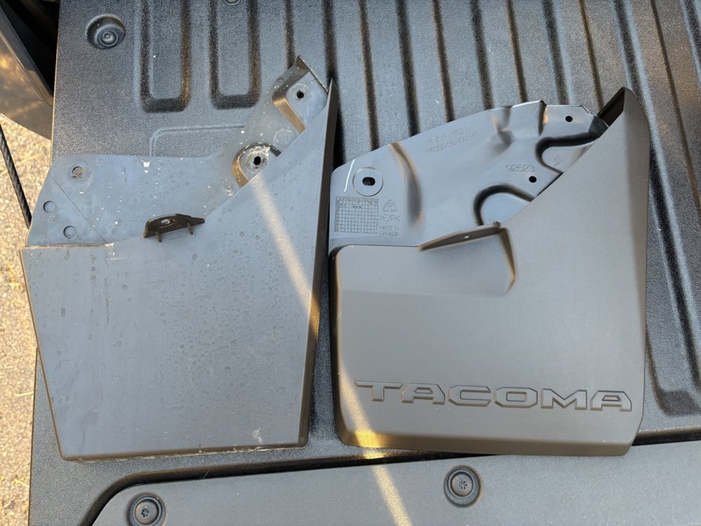

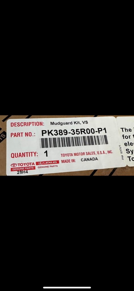

    this part number is correct

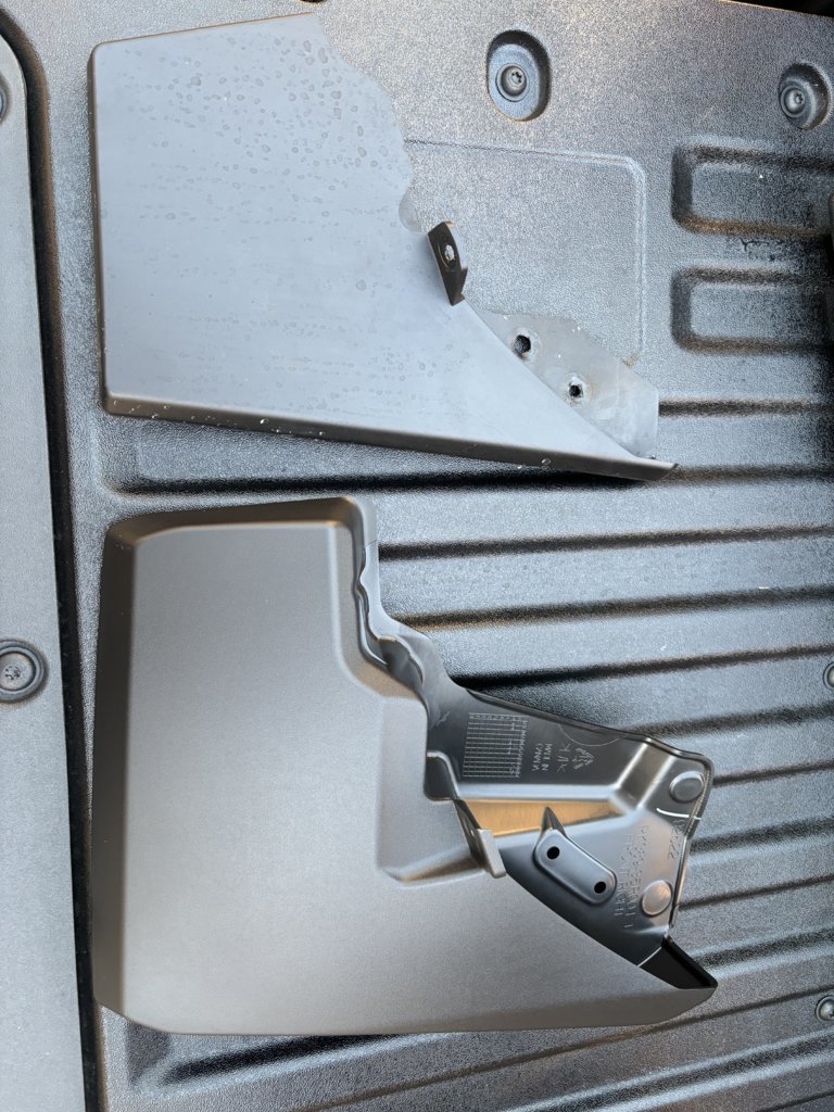

    Sep 28, 2009
    #23471
    606
    Rick
    central Mass
    2024 Trailhunter
    Not Enough
    I believe the (new ones) are the Canadian version. Looks much better for protection I removed the small stock ones the day I brought my truck home

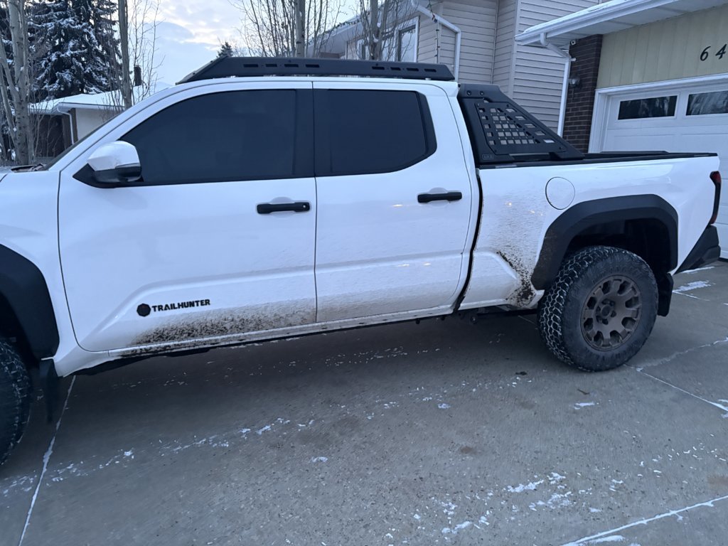

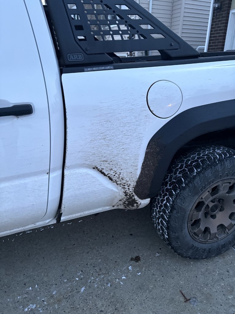

    Lots of people come i here and yelling to add mud flaps lol. Great input, thanks. We all know mud flaps prevent rocks.
    I started this thread because I had a 3G taco for 10 months that I drove at 40-70mph on gravel all the time for an entire summer, lifted with wider tires, and had less rocks chips on that truck when I traded it in than I did on my trailhunter within a few weeks of buying it. So something obviously changed in the design that significantly increased that chipping, and it’s not just paint. Paint doesn’t chip without rock contact and the difference between the 3G and 4G paint quality is not enough to be the source of the issue.
    Some notes:
    - The Trailhunter came with fairly reasonably sized mud flaps from factory (Canadian versions)
    - The trailhunter comes with rock sliders which do not provide any coverage beyond the bottom edge of the rocker. Since this is a ‘feature’ of the truck, most people are not immediately replacing these when they buy the truck.
    - I ordered a bunch of things in anticipation of getting set up for rock protection (wide sliders with top plate, larger flaps, booked PPF installs), but even the smallest amount of rock exposure made a surprisingly significant impact on the truck very fast. Unreasonably fast.
    - Yes, it’s a geometry issue and there are things you can do to resolve (and many are doing).
    - I’m definitely not surprised there is rock chipping from driving on gravel, but again, the low speeds at which I was driving to avoid it did nothing to limit the issue; I can’t imagine how it would look with regular speed travel all the time.
    I think vitamin was right, the tires likely throw more rocks than others. These mediocre wrangler territory RT have narrow tread blocks. I’ve purchased some studded winters to go on the stock rims and will be putting new tires on new rims next summer. I’m interested to see how much crud gets thrown on the side of the truck with the winter tires vs the wrangler territory. Also think you’re right about the selection bias and type of drivers taking their trucks into various scenarios.
    My parts are all in and quotes are just coming in. Toyota has ordered the new flares for my truck already. I’m hopeful to get the repaint done in the next month and a half or so. Likely just after Christmas.
    Meanwhile, here are some photos showing snow/dirt coating the truck and how the pattern looks on the side. The lower front corner of the side actually catches almost no dirt or rocks compared to the area above and behind the crease. The front edge of the flares is of course a magnet for dirt/rocks; I think more is ‘catching and staying’ here now because of the textured surface due to the chipping. Of note; I’ve removed the factory sliders because I sold them ahead of installing the new Greenlane Off-road aluminum hybrid sliders.
    Some items to do on my truck:
    - Get rock sliders powder coated
    - install new flaps (rally armor)
    - get truck box re-painted.
    - get PPF installed along entire box side.
    - install matte PPF on new fender flares
    - install sacrificial PPF piece over the leading edge of box side/rear quarter 3M after above steps.

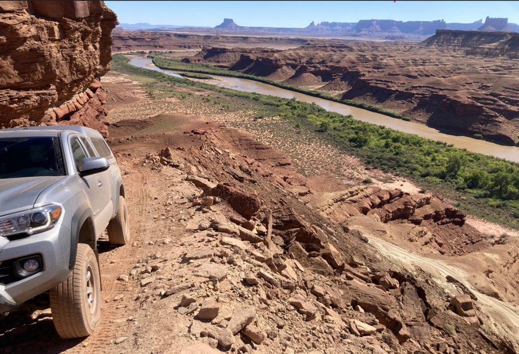

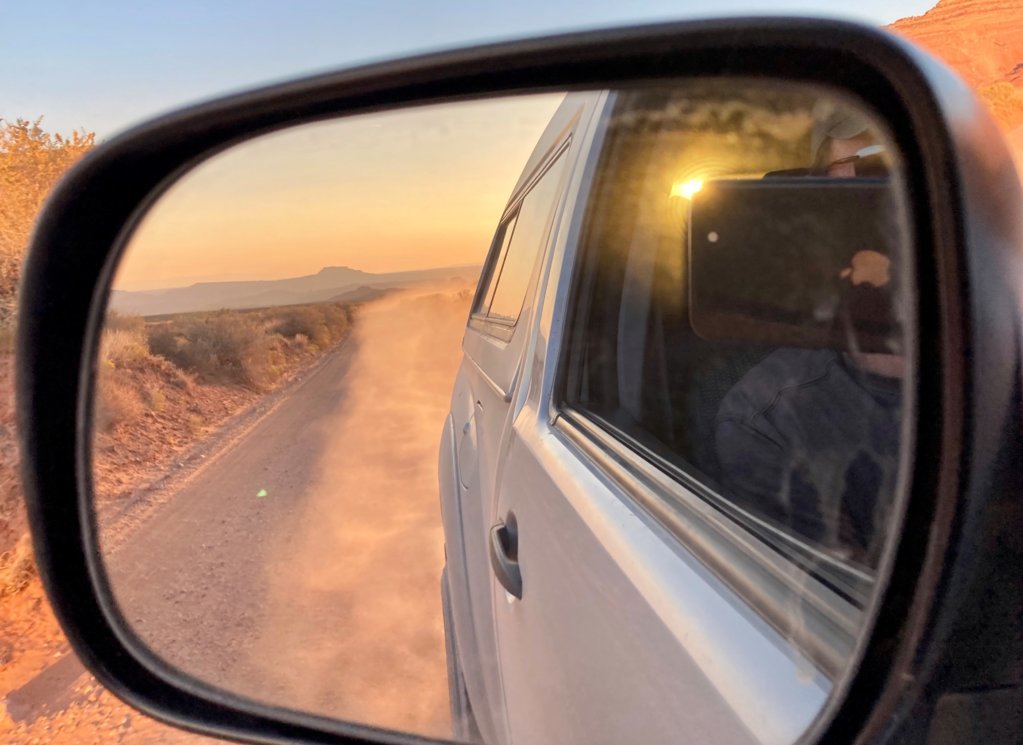

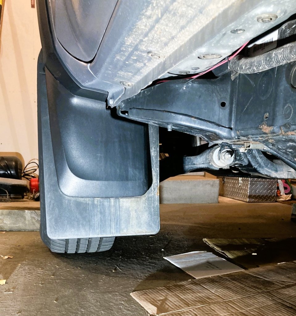

    Proper placement of the flaps are critical. Make them long enough and wide enough and they will stop the shrapnel. Will they look good. NO! Will hard plastic flaps work as well as rubber flaps? NO!
    When you run zero offset and wider wheels with larger than stock tires on the 3rd gen it changes the amount of damage from dirt roads vs the OEM tires/wheels. Will look similar to the 4th gen. No cure unless you install something to block what the tires throw.
    I've had many sports cars with 200 treadwear "super 200s" or "endrurance 200s" for track use. Run them on the paved public streets and you will have exactly what is happening to your new 24. Just sand or minute pebbles on the streets will cause damage due to the sticky compound tires. Flaps are the only cure. Will they look good. Never!.
    Doing this stuff at 50+ mph with zero offset wheels and aftermarket tires on graded gravel roads will have any gen Taco getting the paint pulverized, especially in 4Hi and drifting curves. Flaps will stop it.
    2nd gen
    3rd gen
