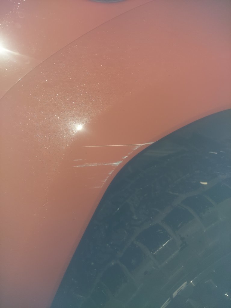

    Sadly, i do not know how this happened. I noticed it in the parking lot last night. It appears like i can scrape/buff some of it off. I rubbed with micro fiber but it didnt solve it. Any suggestions?

    You're going to need some polishing compound at the least IMO. You can try it by hand, but it may take some effort. I have a 6" long throw DA polisher that I break out in these cases. If it's just paint transfer it should come right off, which is what this looks like to me.
