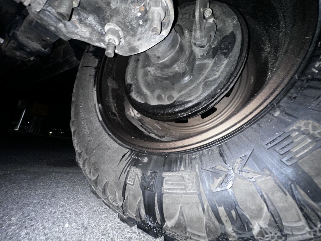

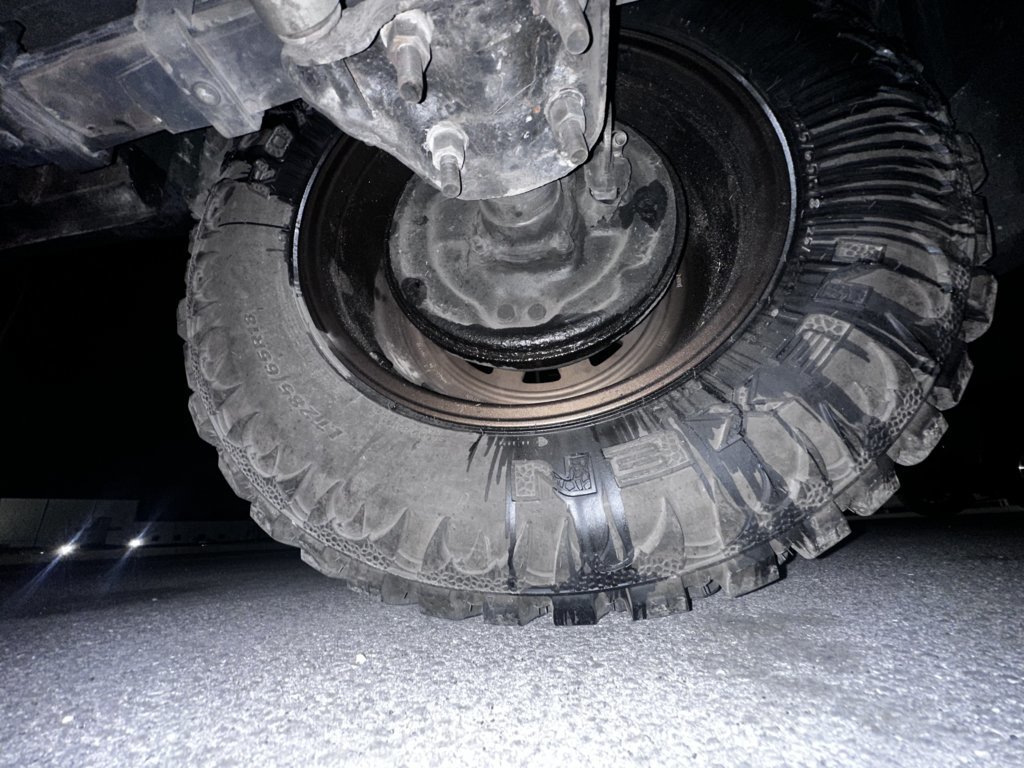

    Is anybody had the rear Chef seal leaks? If so, what are the procedures you guys been taking it and specifically what parts do I need to order? If so, I noticed it this morning my rear right wheel was leaking.

    You're gonna need new brake shoes as well, since your current ones are soaked in gear oil.

    inspect the diff breather to make sure its not clogged

    The seal is installed into the axle housing, and does not come out with the axle shaft and endplate assembly. You could pull the shaft and take it to a mechanic to replace the bearing, but you'd be doing the seal yourself.

    According to Timmy if the seal is done wrong......4 runners experience......It takes about 20K before it starts leaking again
    safest thing to do is do the grease test to see where that seal is gonna ride on that pressed ring...
    dry assemble it.
    if the lip rides at center.....it could start leaking at the taper...
    others use a marker to make lines on that ring
    For the mechanics that do toyotas all the time.....they already know this
    thats where he got that mr coffee mod.....where they flip the ring
    you have to lube that ring and gently cokes that back together, so it doesnt flip the edge of the seal lip over
    I figure just using any random mechanic......have maybe a 25% chance of doing it correctly with the new redesigned seal.
    Just sticking in a new seal on exsisting ring has a low chance of success
    ...alot of shops are going to try to do this.....20k fix

    Trying to gauge how much work you're trying to do. Replacing the bearings and diff breather is probably the right call, as either one or both of them are contributing to the problem.

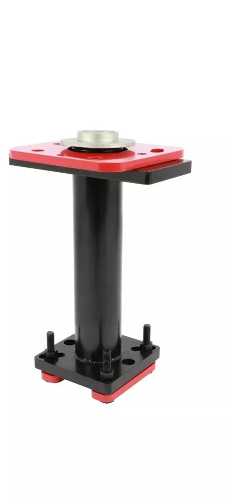

    Replacing the axle seals is an easy job by itself as long as you have a good way to drive the seals in. Either with an actual seal driver, slowly and evenly with a brass drift (REALLY DON'T suggest this), or with a DIY driver. A DIY driver could be as simple a 4x4 that you cut down to be the same size as the seal. I would suggest getting an extra seal. If you haven't driven a seal before, you're probably gonna mess one up.
    The bearing job isn't hard, but you need tools. Press, and tooling to press out and in the bearings. Both Timmy The Toolman (Toyota Rear Axle Seal/Bearing Replacement (ABS Rearend)) and Adventure Taco (Step-by-Step Replacing Rear Axle Seal & Bearing w/ABS (1st gen Tacoma or 3rd gen 4Runner) – AdventureTaco) have detailed instructions for this process.
    You'll need to bleed the brakes when you're done, but before that you need to prevent as much fluid loss as possible when you pull the axle shafts out. So have a plan for both.

    Have you verified that the axle itself is not tweaked or bent? A bent axle or axle flange can cause bearing and seal failures.
    Put the rear axle up on jack stands and run the truck in gear. You are looking for wheel wobble. It may also be possible to spot this in your side mirror driving down the highway.

    everyone sure that leaking part isnt the drum brake wheel cylinder??
