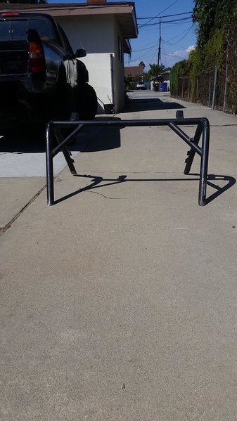

    just bought this bed cage for my 4x4 tacoma. any pointers on installing it. should i run the shocks almost straight up and down as the stock ones go towards the front and one goes towards the rear. how would i run both towards the cab with the gas tank where its located

    you wont know until you cycle the leaf pack and measure where is the best point at full bump and full droop. with shocks extended and collapsed.

    okay thanks. so far i have that cage and a set of allpro expo leafs. just waiting to buy shocks, shock perches and shackles but dont kno what size shackles to get either because i want to retain my 4x4
