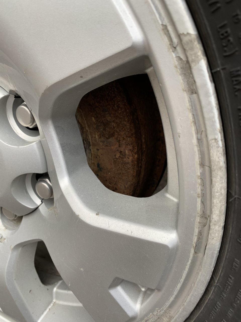

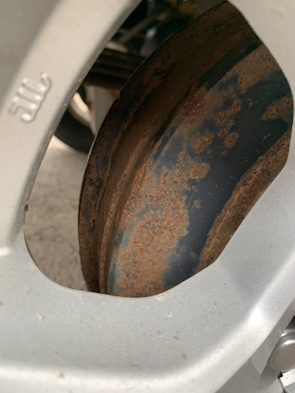

    1st gens have a hole you thread a bolt into. Easy peasy.

    Just clean it up and paint that shit.

    You can insert a correctly threaded nut into the drum face and that will pop it off. Nothing a wire wheel brush on a drill and some black paint wont fix!

    They all do try it at about 100K it will pull the threads out before it comes free.

    Ah, I just serviced my brakes at 160k with no issues... I did however, utilize an impact gun on said nut!

    I live in Maine I have owned 5 from a Hilux up of these things I owned a foreign repair shop more of these things pulled the threads out of the drum than came off easily. Some I have had to drill small holes in the drum at the axle hub then heat them with a torch to get them off. But I'm glad you had no issues.

    until the rust eats the threads. ask me how i know

    Paint the drums red. Adds character & it gives your truck character

    @kmkopp2011 , you can edit the title of the tread so your noobness isn’t so evident.
    To do this correctly, you would change “rotor” to “drum”

    I bought the rock auto centric rear drum brake kit that came with the brake cylinder, brake drum (that rusted part) and brake shoes.
    I have about 135,000 miles, and luckily I had the set in my garage ready to change. One cylinder blew and leaked brake fluid on one side and I lost like 80% braking power. It may be time to at least check and inspect it.

    For sure pull them off,clean them up and paint them with high temp. engine paint.
