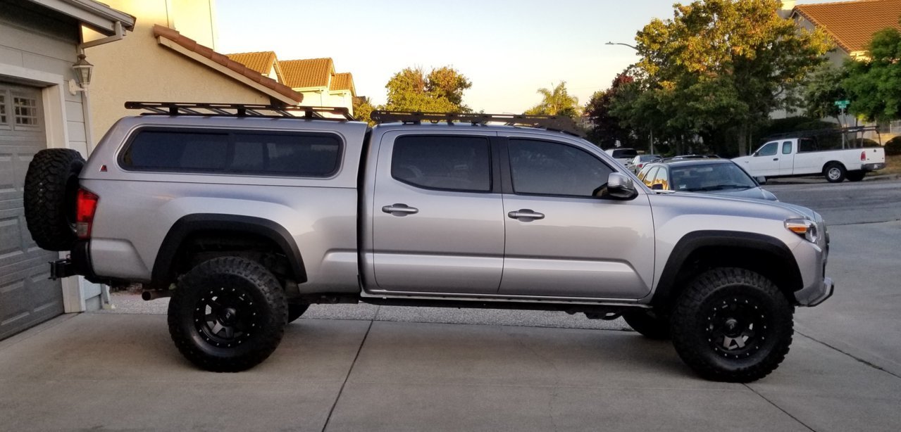

    Get cmc done, alignment to max caster. And Chop until no more rub when wheels locked left or right. Also get durobump stops to keep from bottoming out. I also wouldn’t recommend you maxing out your ride height on those bilsteins.. they make for a shitty ride. Set them on notch “0”, then you will have a better ride.. promise you that. Other then that, you good. My truck on 33’s mt-01 falkens For your time and comparison
    Edit: i also am running spidertrax wheel spacers 1.25”

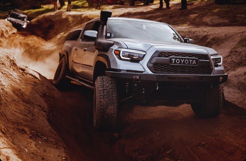

    Tuned Fox 2.5 resi with dsc, JBA HD UCA, total chaos knuckle gussets, rear trd pro fox shocks, Deaver U402 stage 1 rear leafs, archive garage u bolt flip with fox 2.0 air bumps, White knuckle off road rock sliders, BAMF 1/4” steel skids, Magnaflow exhaust, Archive Garage Hammer Hangers, Cbi high clearance rear bumper, 285/75/16 tires.
    That’s a lot of frame flex between the bumper and body of the truck, either that or ur bumper was cut by a blind epileptic monkey haha.

    My thoughts exactly. Real quality metal/fabrication "American made" produces. Lol.
