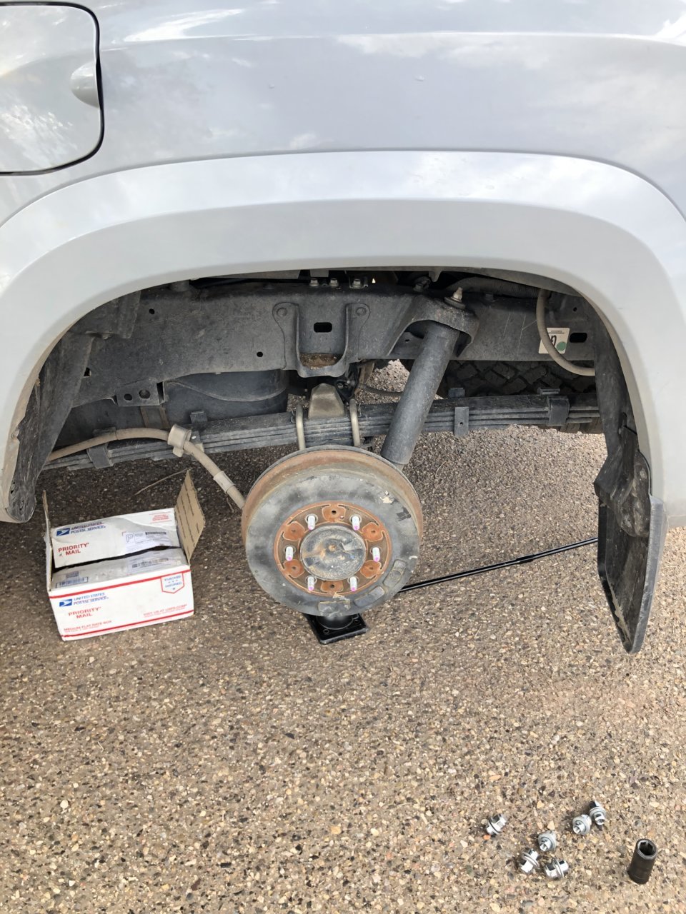

    First off I apologize if this has already been covered. Recently put a Rough Country 3.5” lift on my 2008 Tacoma. After install I noticed the rear sitting approximately 1” lower then the front. For the rear I installed the blocks and the N3 struts.
    I’m wondering if the sag is coming from the fact that I have almost 200k miles and the OEM leaf springs are worn out? This is my daily driver and won’t have any weight in the bed and will not be towing
    New leaf springs? AAL? Any advice would be greatly appreciated.
    Thanks in advance, Scott

    Its possible that the new lift kit lifted the front higher than the rear making it look squatted. Take a pic of your leaf springs and someone here can tell you if they look like theyre sagging. This is what my sagging springs looked like before i replaced them with a new Dakar leaf pack

    Sounds good. When I get home from work I’ll post a pic. Thank you.

    I would go with a new leaf pack.
