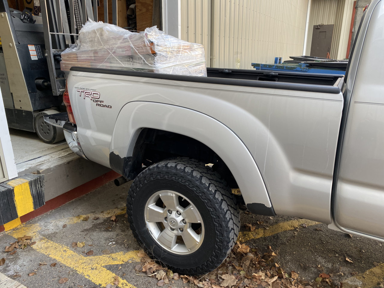

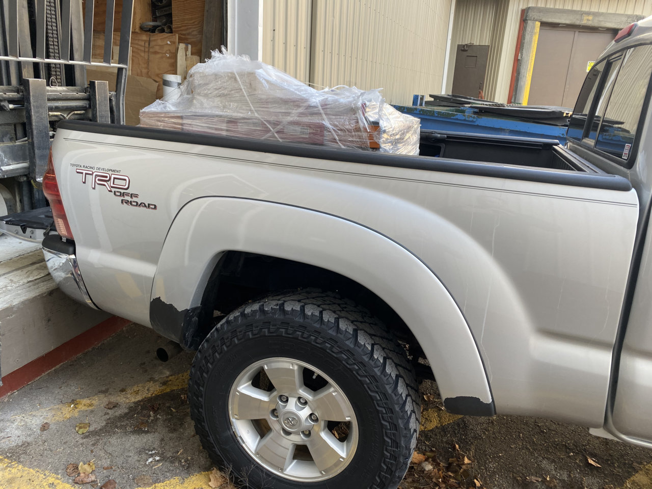

    FWIW I have the exact same truck with the TSB springs and Progressive AAL. This is the before and after when hauling a pallet of tile that was at least the weight you're carrying and probably more. I'm guessing 800-1000lbs range. Hope this gives you a better idea of what you'll be expecting.
    I will say the ride is stiff but that could also be the 10-ply tires.
