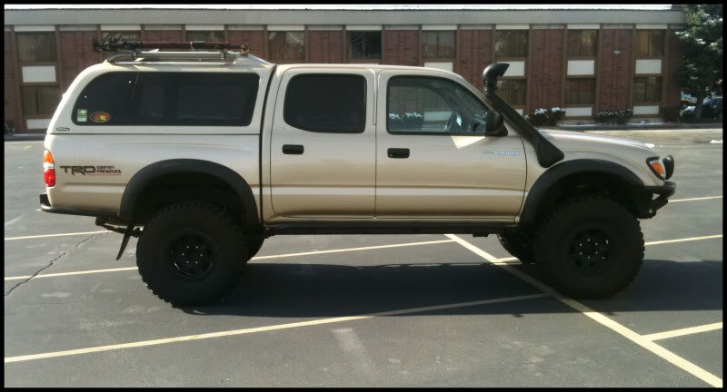

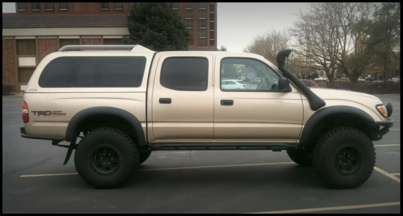

    Yep. Your best bet would be replacing the rear leaves with something that will handle the load better. In the short term you could just use an AAL or airbags.
    I am running the OME Dakar springs and have a snugtop. With the just Dakars it still sagged until I added the OME AAL to go with it. Helped a lot with sag and load capacity.
    Before with just Dakars
    after with Dakars and OME D6XL AAL
