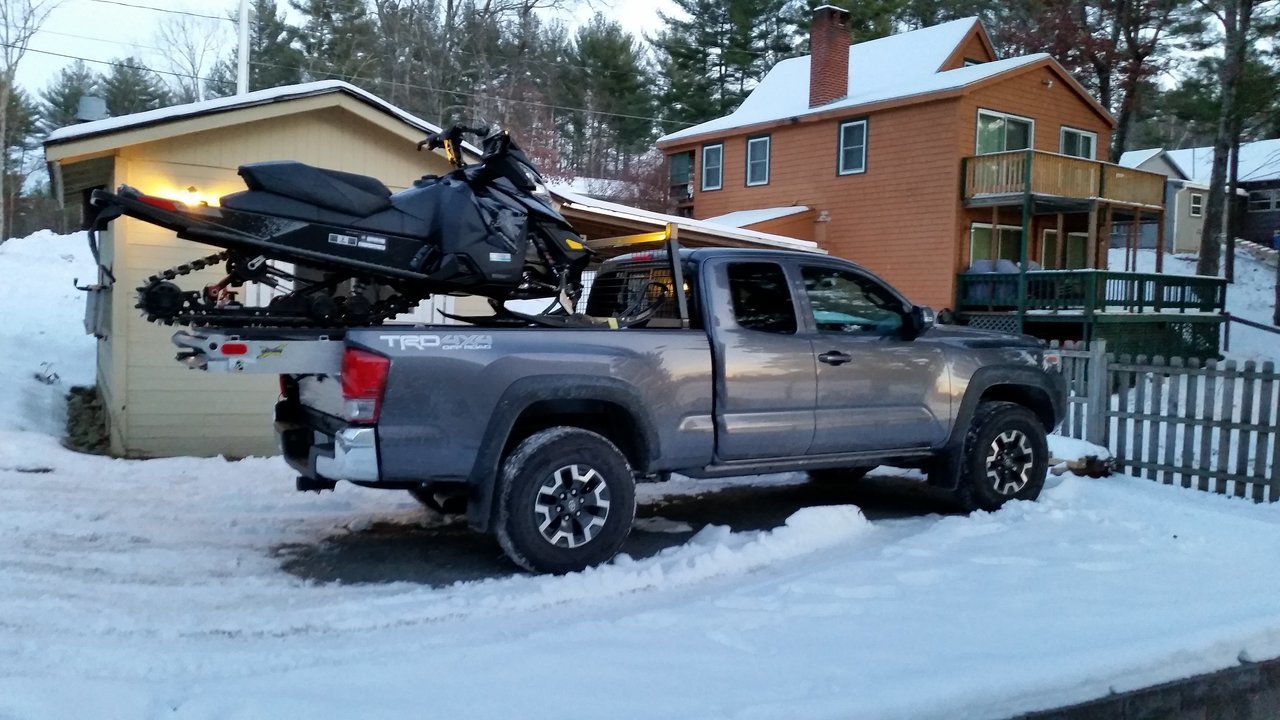

    If your leaving the top on all the time, then sumosprings are perfect for your use case.
    If your only having the top on some of the time, and going unloaded some of the time, then go with airbags.
    No reason for a lift.
    Don't get spacers or blocks.
    Here's how mine sits with sumospings and about 800 pounds in the bed. Everything else is stock TRD OR suspension.

    That looks damn good! Looks like Sumo Springs may be the better option!
